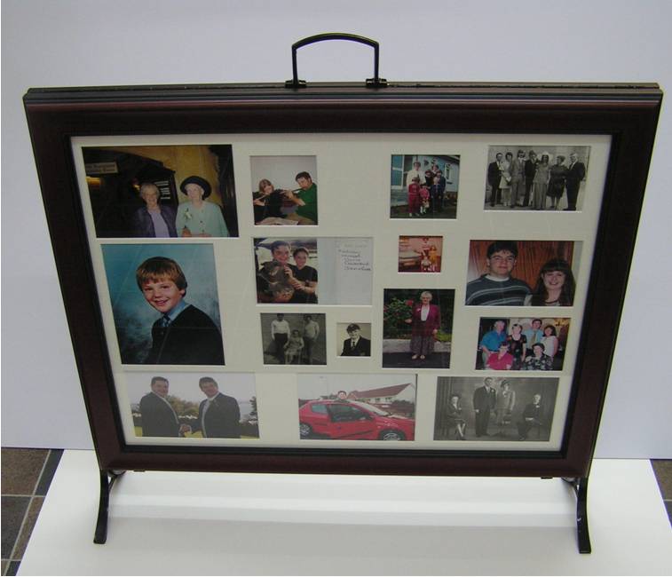

Here is one we did a while ago for a customer. This is a double frame, back to back, containing a collage of family photos and memories.
The fittings are the lion fittings but the customer wanted them black to match her fire tongs! This meant we had to paint all the metal work including hinges, screws and clips. The two frames are hinged at the top and have clips underneath to keep them shut. It was quite complicated fitting it together and I don't use this as an example for customers but it was fun putting it together.
Fire stand.jpg (48.92 KiB) Viewed 5582 times
The thing to remember with fire screens is you need a solid moulding that will support itself standing up, has a rebate deep enough to take the contents and the side of the moulding needs to be flat and deep enough to screw the feet on. Time yourself putting it together to ensure you don't undercharge for the job, on the first one you surely will, but it is practice as well for the future.
