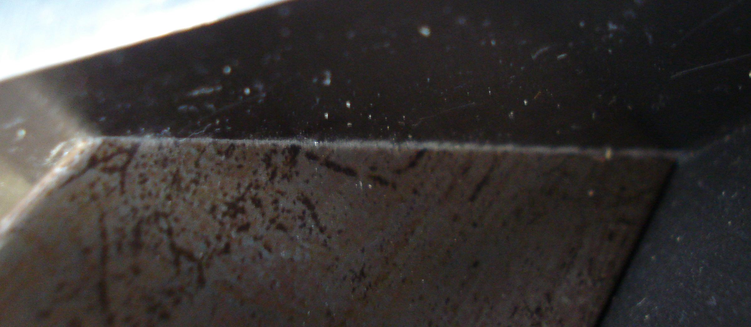

Dear all, am using a mitre trimmer/guillotine from DIY Framing and have noticed something curious. Wondered if anyone could shed any light.
Basically, as the blade finishes it's pass through the wood to complete the cut, it seems to hook so that if I keep the moulding tightly in place and withdraw the blade (still holding the wood tightly in place) there's a tiny gap between the inside of the mitre and the blade. I'm holding the moulding as firmly and tightly as I can from the start of the cut to the finish, and I've tried it on several mouldings, and on both sides of the trimmer, and get the same result every time. Problem is that all my mitres are tight on the outside but have a hairline gap on the inside
Is there anything I can do about this?
many thanks,
David
Pic showing moulding fitting tightly against blade at end of cut:
end of cut.jpg (1.95 MiB) Viewed 5258 times
Pic showing gap left once blade is withdrawn:
blade drawn back again.jpg (1.05 MiB) Viewed 5258 times

If it aint blunt blades then sounds like the fences are moving slightly.
Are the hex bolts tight in the base which clamp the 45 degree stops in place?
Are you just relying on the stops and springs to maintain the angle of the fences? They need clamping firmly as well with the thumbscrews on the ends of the fences.

I had similar problems.
We used a metal 45degree angle pressed tightly against the blade then the arm was brought into place.
We held it firmyl to ensure that we could not push the smallest feeler guage available on the market between either the blade and 45degree and the arm. We then tightened the butterfly screws with a pair of pliers. End of problem. Hope this works for you as well.

I have a similar machine, (branded Alexander), and have found that it is tricky to keep it correctly aligned. I often find that the fence has moved back a few mm from the casing under pressure, especially with wider mouldings. I've tried wedging the fences but have not yet come up with a foolproof method. Be wary of using pliers etc to tighten the thumbnuts - a friend with a similar machine did that and cracked the casting! If anyone has got this sorted I'd be very happy to know about it.
