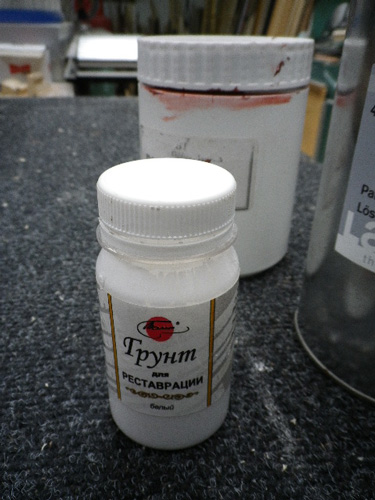

Today a customer brought in a late 19th/early 20th century compo frame, it's nothing special and has been overpainted with about 6 small areas of ornament missing. They don't want the expense of removing the overpainting and returning the frame to a very good original condition. They just want the missing bits replaced and with a gilt finish to match. I'll do a step by step photo guide on this frame next week and post on the forum, instead of on my blog.
After I have taken the moulds the new bits are then made. Sometimes a piece of ornament can be cast or moulded by simply putting a piece of the epoxy putty (Magic Sculpt) in the missing area (as close to the exact amount needed) and then take the mould and press firmly into the putty. Alternatively the putty can be pressed into the mould and left to harden, it can then be trimmed and sanded to fit exactly. Both these methods are suited to small repairs using a semi flexible mould making material (like Otoform).
If using compo you need a hard mould, most of the silicone or vinyl based moulding materials are too soft.
Once the repairs have been glued in place and set they are painted to match the colours used originally, underneath the gilt finish. In some case gesso would also be used first. For this ground colour I use either bole, Pelikan Plaka, water based or acrylic paints. The ground colour used would depend on the end finish that is reqired. Some frames (more valuable) would be oil or water gilded as closely to the original finish as possible and then blended in to the surrounding gilding. On ordinary old frames of no real value or where the whole surface is finished I may use an acrylic or oil based gold size and metal leaf. On jobs like this you could do the repairs, then paint or spray surface with red oxide paint, and then use acrylic gold size and metal leaf. Like Prospero said, shellac can be good for providing a key or foundation.
I have one trade customer who has a standard finish on most of their old and antique frames which is metal leaf combined with bronze powder, finished with button polish mixed with pigment, and medium oak wax.
The actual finish on a restored frame will depend on the existing finish and budget, if it is water gilded then this is the only option really, anything else will not blend in that well. But if the finish is a gold paint then I would use whatever works, bronze or mica powders, Liberon, Rub & Buff, or Goldfinger gilt creams, or metal leaf.
So once the repair is gilded it is distressed and toned to blend in with any original gilding. This can be done in so many ways. Tinted glazes or washes, coloured microcrystilline wax, rabbit skin glue with pigments, shellac, and so on. Finally I would often seal any repairs, or the whole surface if the entire frame has been refinished, with an acrylic spray varnish. This is especially important if I have used bronze powder or metal leaf as they will tarnish quickly if not sealed.
An acrylic filler used to make repairs to frames, quite similar to a fine surface fillerprospero wrote:(What is Russian for 'Polyfilla'?)
- IMGP1754.jpg (67.98 KiB) Viewed 7779 times

I am waiting for these photoes, Richard
And it's so nice to see a picture of russian primer in a british forum

Re: Restoration in a framing shop
Richard,
And your sharing is really hugely appreciated. Everyone has to learn from someone, and I think sharing techniques is the only way to keep some of these traditional (and not so traditional) methods alive. But I still think you should write a book
