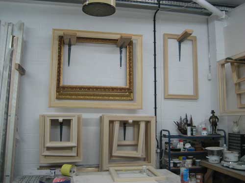

I think it's best to store the long lengths vertically if possible. I also keep mount boards (mat boards) in vertical racks.
Shelving brackets with a piece of wood covered in foam are useful for keeping frames off the floor:
