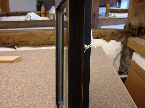

Moulding is Rose & Hollis A115 Ash, ebony dye, sandpaper distressed and wax finish.
Obeche slips SL2 & SL4 F&B paint, distress and wax. The sock is attached with embroidery cotton.

A great job David, can you explain how you made the "tray" that the sock sits in?

cliff wrote:..can you explain how you made the "tray" that the sock sits in?
It's a coved box design (or tapered box) see this topic: http://theframersforum.com/viewtopic.php?f=11&t=4156
I cut mine by hand.
There is more than one way to create depth in a frame and I know that this method is not to everyone's liking, but I like it! I first got to know about this method from this video: http://www.youtube.com/watch?v=fAceyYn5 ... ure=relmfu there are 4 videos in total.
(BTW, can anyone tell me how to embed a youtube video into a post?)
The box has an middle, inner and outer layer. More photos:
In hindsight, I think I'll keep some brown picture cord in stock for furture jobs!

you could stain the cord.
