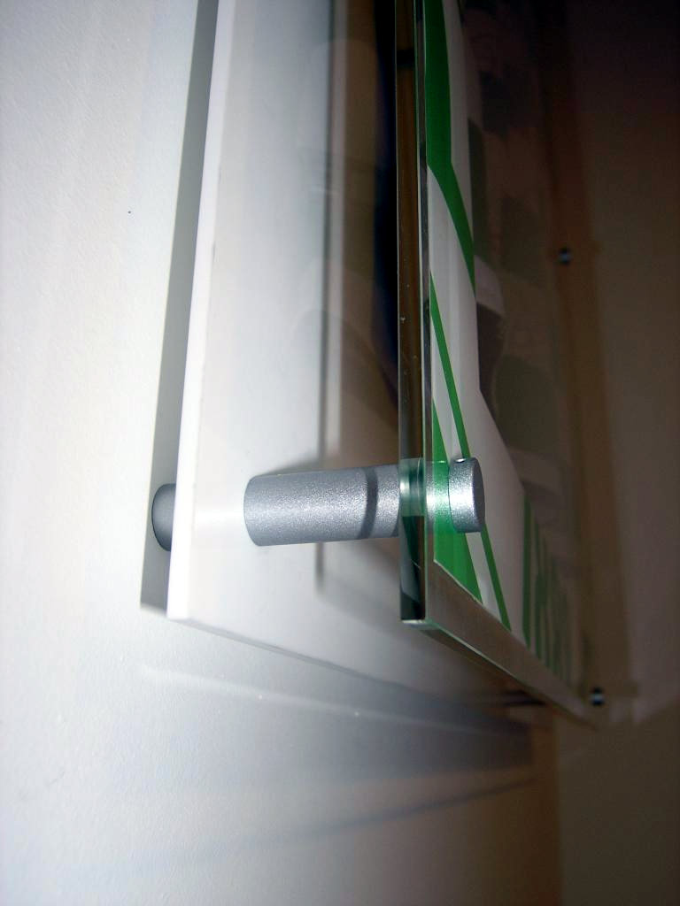

These 2 images give you a better idea of the construction.

So are these displays open to the elements at the sides,
sorry I'm not calling them frames, as there is not four bits of wood

Yes all open all the way around my good man.
I was worried what people may think, but no one has questioned this or seen it has an issue.
Supply a new front panel with a new team logo, hang a new matching shirt and there you go, more money thank you very much.

The panels are 5 mm Acrylic.
The printing is a vinyl outsourced and the panels are assembled to the wall. Hope this helps?

How are you fixing the custom made hanger please ( shot of one would be nice) and do the shirts just drape from the hangers.
They do look very crisp and modern.

The shirts just hang free and the hangers have a hole in the top which just slides over the centre spacer prior to the fitting of the front panel.
Thank you for all your interest and kind words.
