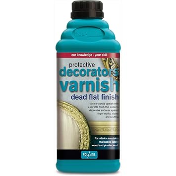

Sorry to bump an old thread but I've been experimenting with spraying ripple paint with good results but I'm wondering if it needs sealing? If so what would be the recommended sealant? I've got a very nice smooth marble finish with the ripple paint after a gentle sand and a polish with a clean cloth so would want to preserve it. I know traditional gesso is porus so will pick up dirty etc but not sure about the ripple paint?

Bit of clear wax. Sorted.
You could give it a coat of this if you want it a bit tougher. Comes in Satin and Gloss as well.

Thanks wax it is. I might try spraying the varnish though as I seem to be spraying everything else....
