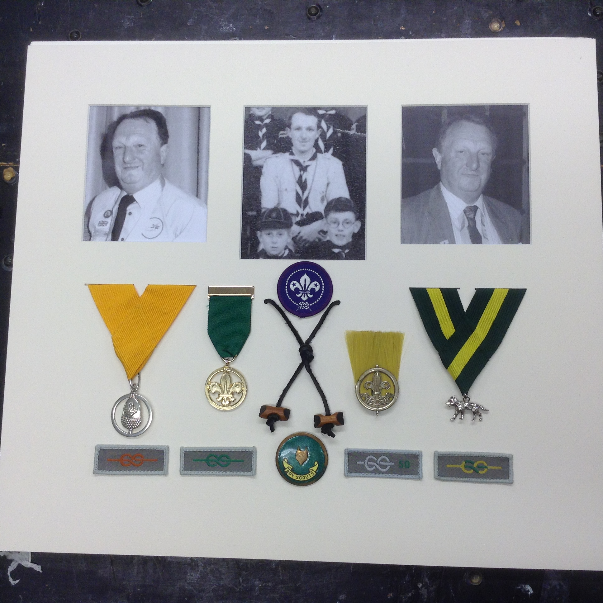

This, re-done!
The toggles were added last, the framer decided they would not be included; the customer said damn right they will be ... but the framer had already completed, so s/he hung the toggles above and right of the badge below, nice! We think the folds in the ribbons have been messed with, we have un-messed them.
The glass is optically coated and either Tru vue AR or Tru vue ultra vue (there was a Tru Vue sticker on the back) so it wouldn't have been a particularly cheap job.
Adhesive everywhere on the front - DS tape for the patches, sticky foam pads for the metal bits. They're not good, I don't care what anyone says. True colours, shining through

Mounted now, photo sent to customer to make sure it's all where it should be. No title this time, that's going on the back.

Customer has said she has been advised that she should put the name and from-to dates above or below everything (below then). Wonderful, won't get that back in the mount cutter now, but fear not, I have a cunning plan!Roboframer wrote: No title this time, that's going on the back.

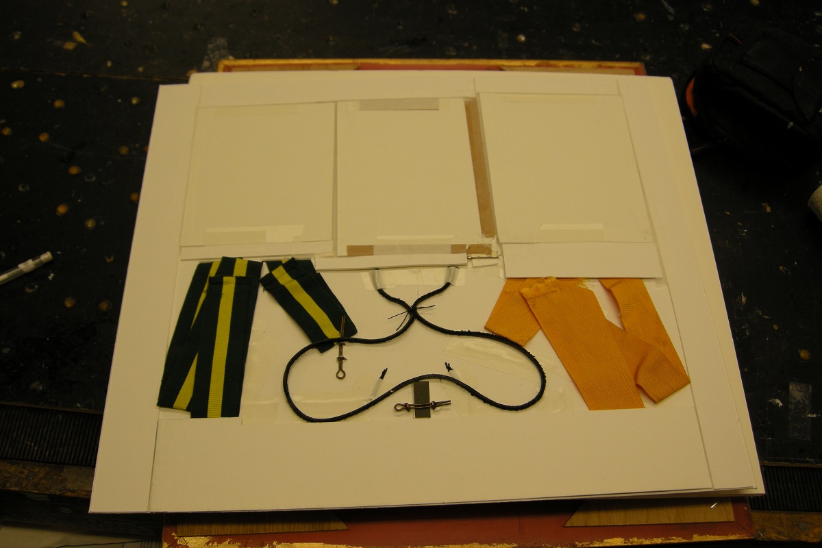

Can we have a pic of the back too please? Looks a lot better to me btw.
Re: Coming soon
Okey Doke.

All done.
I was thinking of putting the title inside a reverse-mitred mount slip but there wasn't enough space really, so I cut a small reverse bevelled aperture from black core board and stuck it to the fall out.
Simons Bret 16, foam board spacers, original glass reduced in size.

Although I do agree that yours looks neater and employs better methods, I'm not sure what the big problem is with the original one.
Okay it looks like the toggles have been an afterthought although it sounds like the customer changed her mind with you so maybe did that with the original framer. And the corner isn't very clever and I would have had to fix that, but I'm not sure that it merited a total reframe from another framer.
