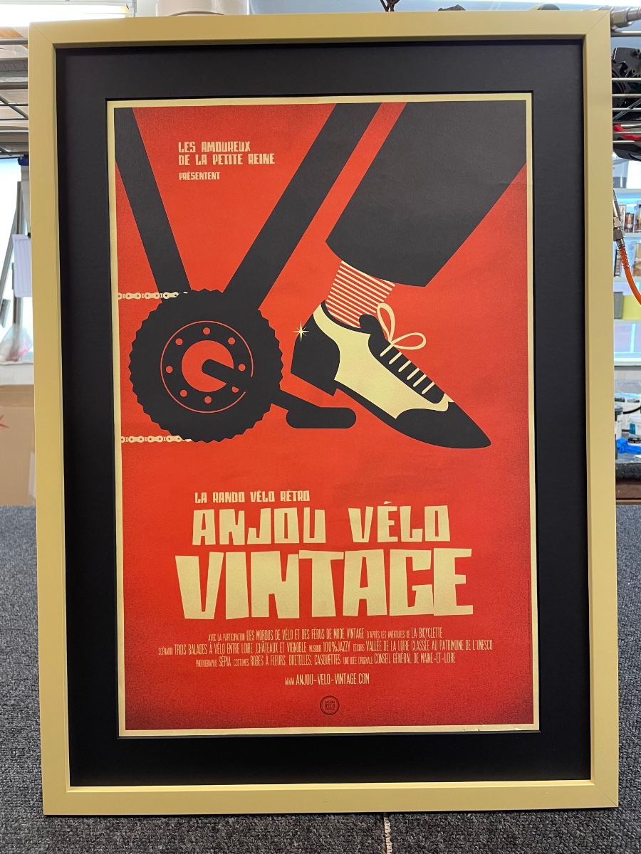

Love the way this vintage French cycling poster turned out. Dead simple black blackcore mount and LJ confetti cream frame was the perfect colour match. Very pleasing to the eye.

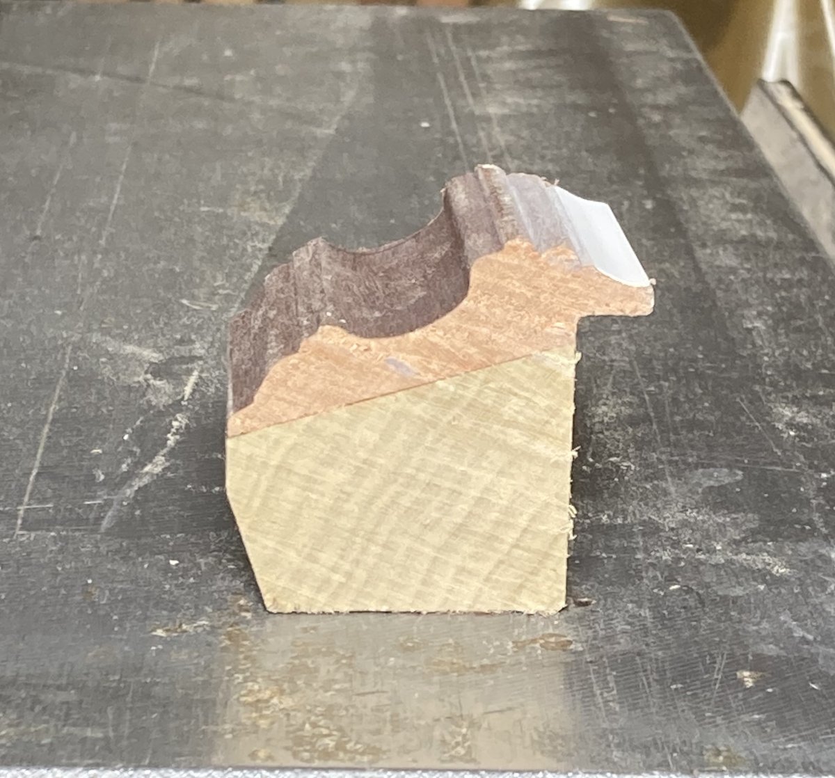

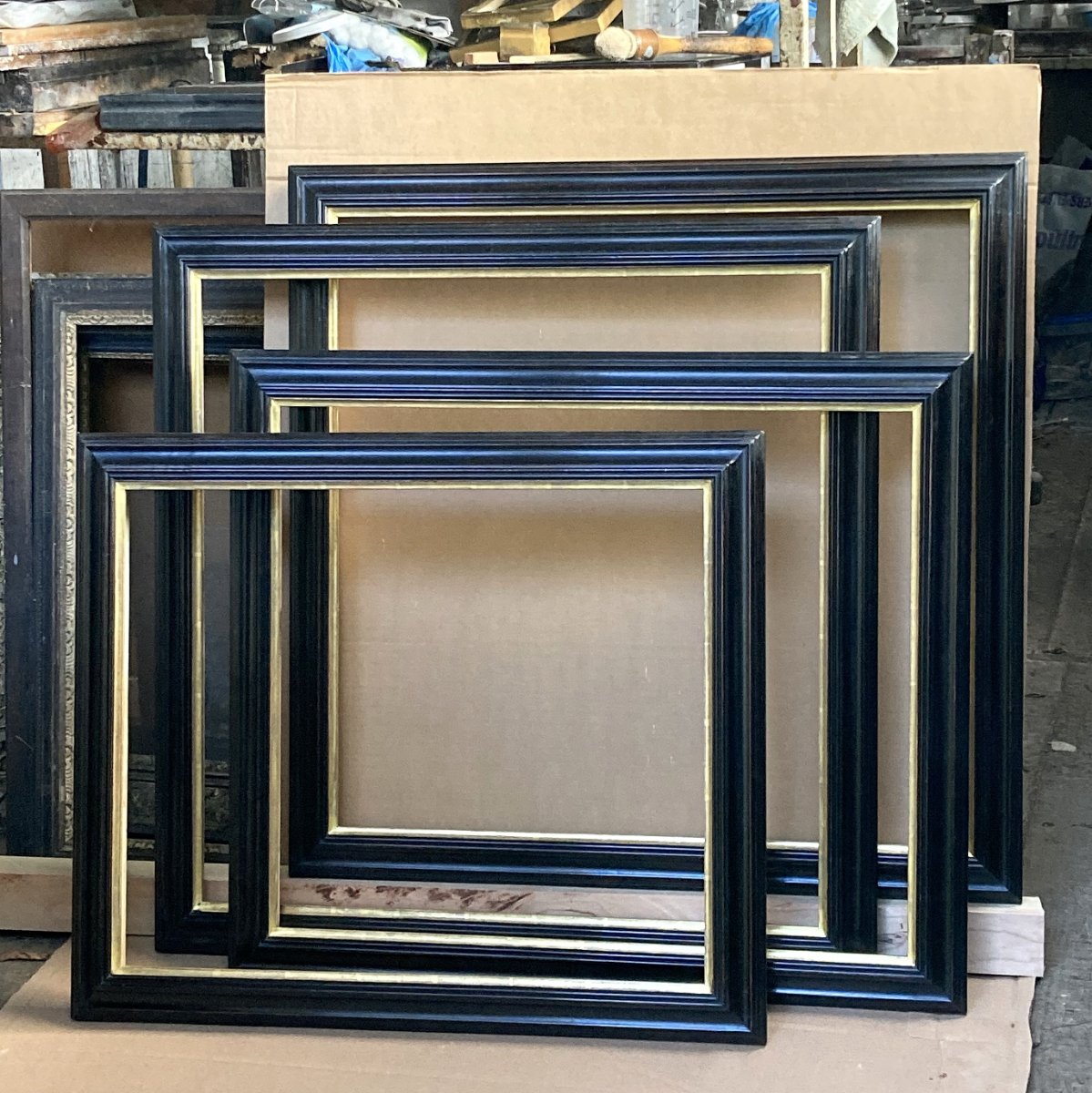

OK, I'll show mine.
I was asked to make a series of period frames to re-frame some of the Royal charters granted to one of the Cambridge Uni. colleges.
Some dated back to the 13th and 15th century.
The frames agreed upon were based on a traditional English reverse gothic style with applied gilding on the sight edges. These were an enlarged version of the profile I've used before on some original William Hogarth engravings.
The finish on these frames relied on the timber having a very close grain effect and the original frames on which these were based would have used Pear or other fruit wood.
I selected Cherry wood as this was available in long planks and had a very similar grain pattern to Pear wood.
To keep things within a reasonable economy, the visible profile would be cut into the cherry wood and the main body of the frame then made up from the much cheaper Tulip wood.

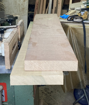

The first task was then to rip up the planks and glue a thin slat of cherry on to a tulip wood base.
The top profile was then milled into the cherry wood first and then the whole section shaped further on the rip saw.
After a layer of gesso was sprayed onto the sight edges the frames were cut to size and joined with tapered keys hammered across the back mitres.
These frames were quite heavy in weight and relied on the strength of this method of securing all four corners.
The frames were first gilded and then treated to several thin layers of ebonising shellac. After all the usual aging treatments, the finish was given two coats of clear bee's wax.
The fine grain effect on the Cherry provided a beautiful clean finish with a high polish further enhancing their value.
These were the first four small sizes.
They hold a dark secret.
Justintime had a hand in making some of them!
The next set are a whole lot bigger.

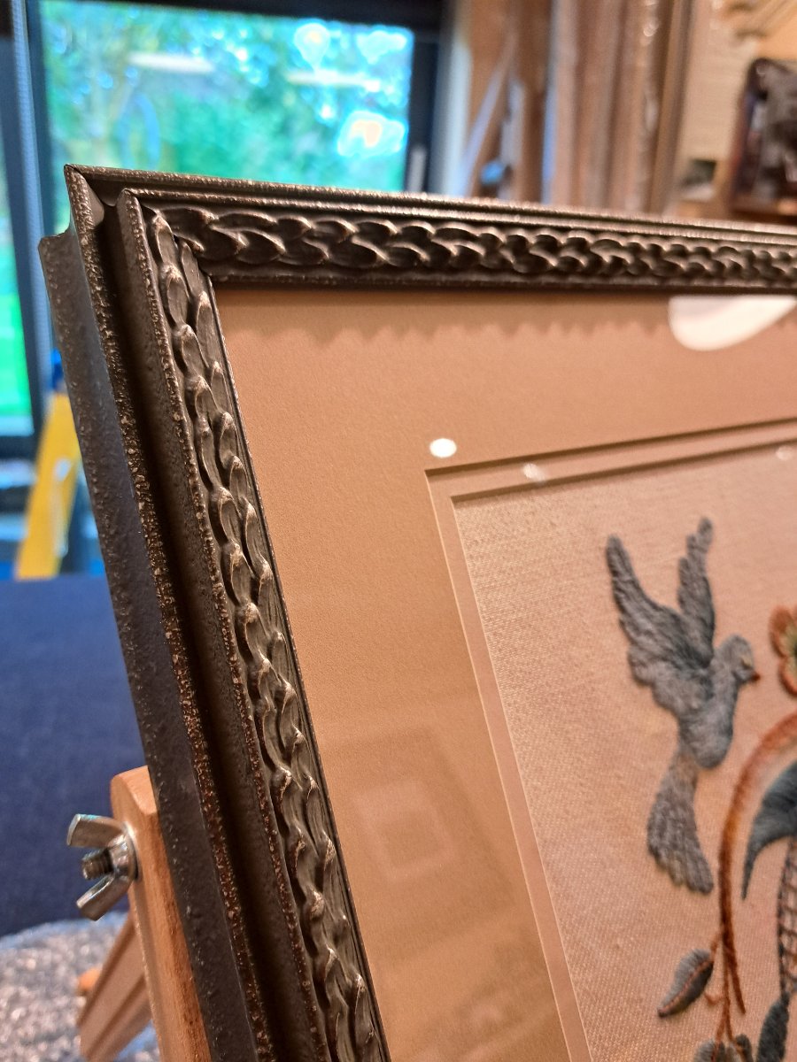

Here's my offering. Customer's own work for judging/marking by the Royal School of something or other, so sewn onto board by her (I'm not responsible for the wonkiness..)
Double rag mount, lovely LJ Sofia moulding, echoing the leaves in the piece, CC99 glass.

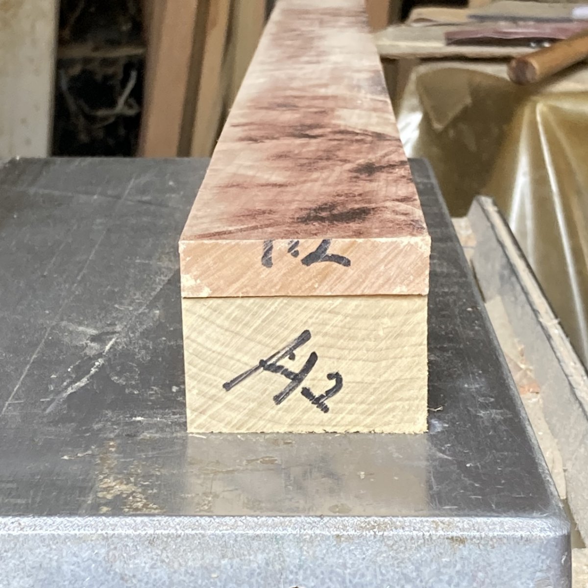

Re: THAT FRIDAY FEELING!

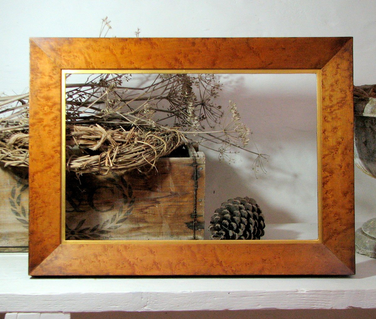

Nobody seems to want to talk about 'hand-finishing' anymore.
I'm sure there are lots quietly beavering away and not much interested in showing off their work.
So,here's one that I'm happy to show off.
It's a Birds Eye maple veneered frame with a thin inserted gold slip.
Ask anyone who's ever tried to reproduce a Victorian maple finish and they'll know difficult, if not almost impossible it is to get right.
For some reason I seem to be the only person doing this.
It hasn't made me famous or rich, but I do get a steady stream of work from galleries and print collectors who value this sort of frame.
Getting back to hand-finishing, if anyone wants to discuss or ask about particular finishing techniques, they are always welcome to PM me or even post it on the forum for advice.
I deal mostly in wood finishes, ie stains, varnishes and waxes. There's Gesso&Bole and Prospero who have better experience with using paint effects for their frames.
And I'm sure they'll be happy to add their expert advice.
Some final thoughts; Most of what you read on the internet about wood finishing is bollocks!
Those who do know something - don't want to share it.
Those who think they know something, but don't, are still happy to splash it all over the internet.
Buy a book.

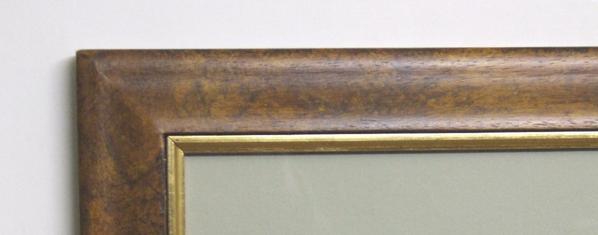

- Posts: 11698

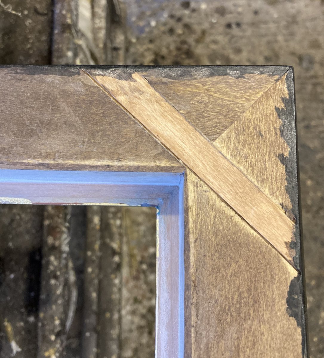

This actually looks more convincing than the real stuff - from a distance.
One mistake: The finish goes over the corners. I should have made the mitres more obvious.
