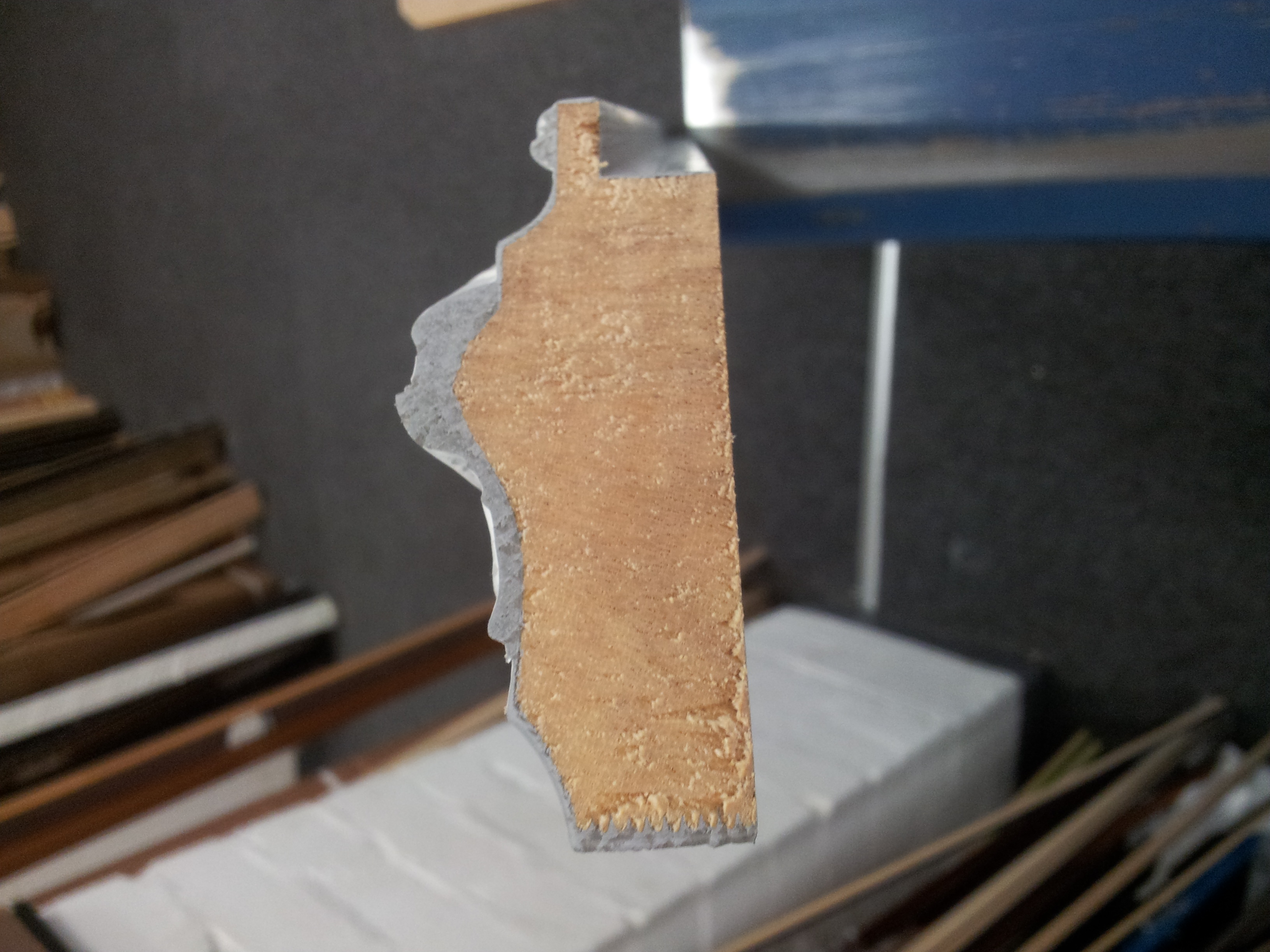

More experiments, we chopped some ornate molding a couple of weeks back this is one of those mouldings you really need fresh blades for, one strip felt very light, I think you all know what I am talking about , the wood was unusable, this was cut with blades that were fairly fresh.
- IFGL
- Posts: 3117
- Location: Sheffield UK
Re: new blades
So remembering this strip of abhorrent mess that was.passed off to us as picture moulding I thought I would test how the FC blades would cut it.
I trimmed about 5 mm off, still not perfect but a whole heap better and I am 2 weeks in on this set.

That is very impressive. I am now two months into these blades and they are as good as new. I used to use a piece of moulding that was similar to yours (we call it balsa wood) as the sign that the blades need changing. No such issues as yet.
