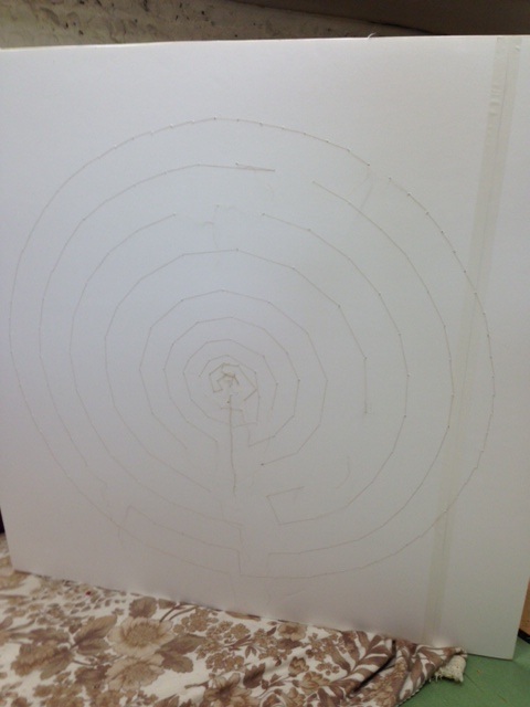

Not me, Paula, my framer - and she pre-punched all the needle holes with a home-made awl made from circles of foam board, mount board, a bit of moulding and a 'T' pin.
The mount board is spliced, centrally - it's 34.5" square - had to be that colour (artcare 'medieval forest'), which doesn't come oversized. Had I used my camera and not my phone, you'd probably see the join. It's bonded to 3mm foam board which is also spliced, but with less care.
See the reddish bit of rolled up thick paper in the bin? That's what it came in/on, had been tacked to and rolled up in it for thirty years!

Nice job Robo, would you post the finished article please?
When you are splicing board together do you opposite bevel the edges and join or just butt them up?
We found opposite bevel then a thin coating of pva on the bevel, join and weight down over night made a very good join, we cut a 2.5 m mount this way

We opposite bevel and rely on the bond to the board underneath - starch paste - not for any conservation reason, just that it does not dry in a hard film and if any squeezes out or otherwise gets where it's not wanted, it's easy to remove without trace. We also weight (big bits of 6mm glass) and allow to dry overnight.
Here's the awl - patent pending - a tiny nick is taken out with the morso for the head of the 'T'' pin

Nice job! I have to say that I admire Paula's determination with the awl. That's a seriously large number of holes!
I cheat and stick a needle of the same diameter into the chuck of a cordless drill and let the drilling action do the hard work instead. Then I cheat again and leave the stitching to my wife "Vee".
Re: Tatting
The awl went through the mount board and the 3mm foam board bonded to it like butter so not much determination/hard work required really, that came with the stitching but again, not that difficult, just time-consuming.
