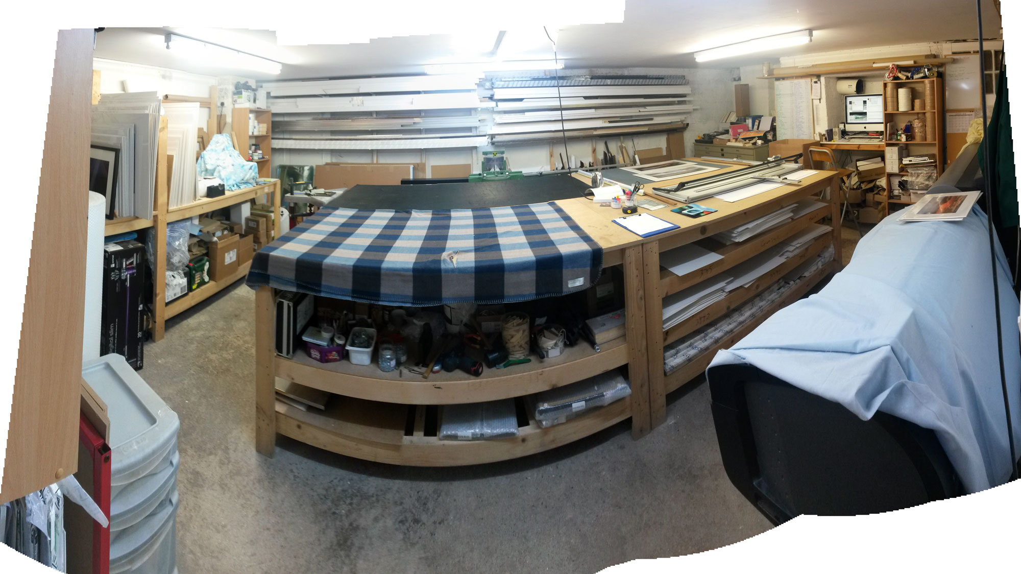

Mine's not flat as in horizontal, it's ..... I'm not sure what it is, somewhere between 30-45 degrees but it's big, it's mine and I don't have a problem using it for whatever else I can, but that would mostly be hinging the undermount to the window mount on larger things, especially when the 'proper' place to do that is spoken for.
Hinging/otherwise mounting artwork is mostly not on as you can't let go of it, it'll slide down the slope and the above can be tricky too.
I've got a huge (not as huge as my CMC bed, admittedly) old counterweighted draughtsman's table at home that will pivot between horizontal-vertical with a foot brake - how useful would that be on a CMC!
