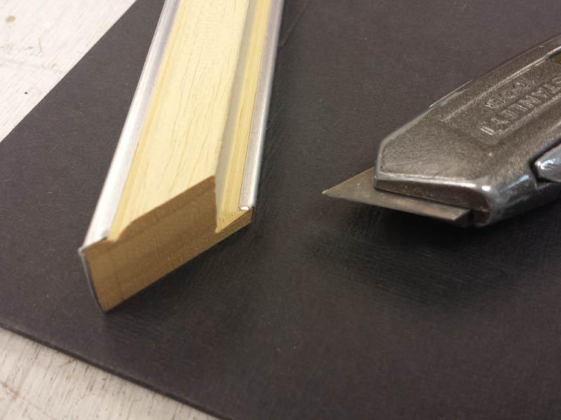

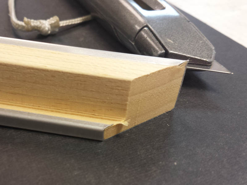

Here is an aluminium wrapped frame that we completed this morning.
We always remove the rebate burr with a Stanley knife and have never noticed any additional blunting effect either on knife or Morso blade, we are not big users though. Maybe someone cutting a lot of this moulding would see a difference in blade life compared to wood - we do one or two aluminium wrap frames a month, though from time to time we have had orders for as many as a dozen.
The Morso blades that this frame was cut with have been in constant use for nearly three months.
