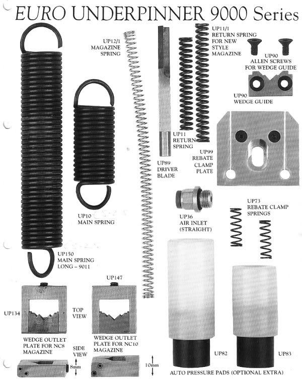

Hi John,
These are the part numbers, if this helps,
BTW, wasn't there something posted about someone supplying Euro underpinner spares, after Euro folded? or am I mistaken?
I Hope you can get what you need.

you might be lucky, it looks like it might be the same spring as in charnwood/framers corner machines - might be worth giving sam a ring at framers corner. 01530 516 925
hope this is a helpful start
kev

I agree with Kev, looks alot like charnwood, I was ablble to get a spring from framers corner
good luck

Well thanks for all the concern and advice folks.
I went straight into panic mode when it went, but as I said I have my manual ('butterfly')one, which served me well for 6 years, buried in the garage.
Uncovered it enough to get at the bolts holding the hammer and wedge chute housing, hoping that the spring would be the same one - rounded off two allen keys before remembering the spring can just be teased out.
Took it down the shop this morning to find it's the exact same one!
Anyway, Craig is bringing a slack handful of springs on his next visit!

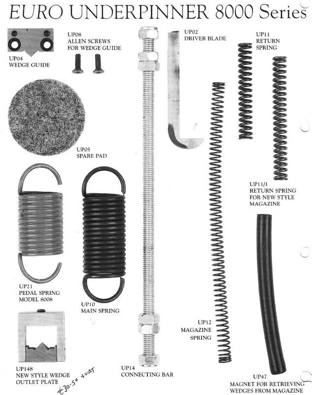

Does anyone have a copy of that great part chart for the 8000 series?

Juliet Rees wrote:Does anyone have a copy of that great part chart for the 8000 series?
Hi Juliet,
Unfortunately, I have to go out this evening, but I'll try to remember to scan it and post it for you. I've got an enormous archive of old catalogues, price lists, correspondance, etc. The people who I bought out kept all this sort of thing filed and were going to throw it away, but instead I got it all.
The early Euro catalogues were divided into sections for each of the suppliers and even included pictures and a short write up of each company, it's so interesting to see how things developed from one catalogue to the next.
Here it is.
While we have both spare charts on this thread and John (Robo) has posted the link containing contact details for the ex-Euro rep who has some spares, now might be a good time for those who have one of these underpinners to consider their future spares requirements. Eventually they will all be gone!
