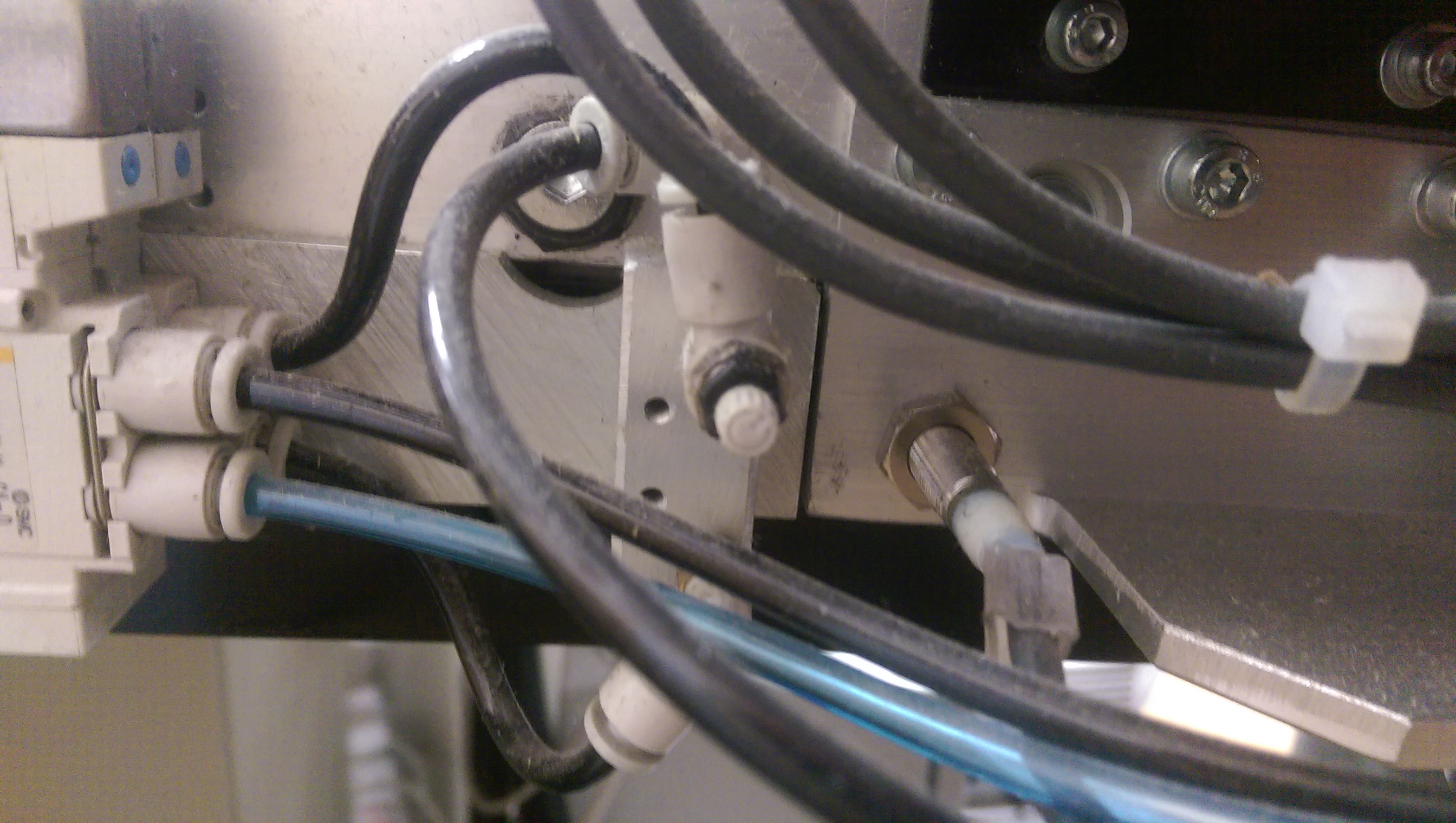

Re: oval cut using Valiani CMC
I can't find one on the tinterweb, I will get Jamie to photograph it when he gets in, it's my day off today.

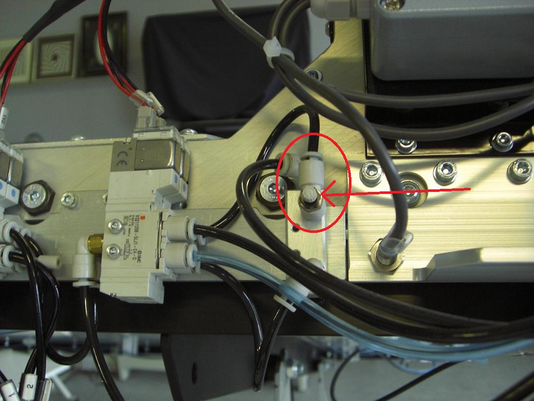

Mark. Can you send your CMC serial number please.
The reason is if the machine is before 2007 there is not a screw regulator on the back of the Y arm.
See Photo.
See Photo.
I have that screw regulator on mine.
The coller seems fine
Can I adjust it?
And yes Merlin yours is cleaner than mine too
Can I adjust it?
Yeah you can adjust it., all it wil do is make the cut travel a bit further.
