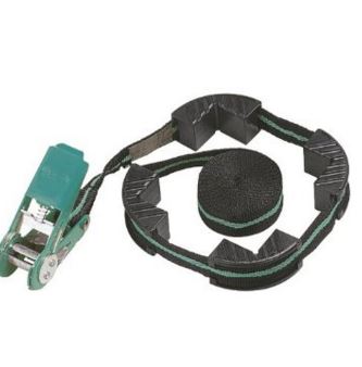

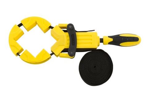

B&Q do a Stanley one that looks remarkably similar to the Inglet one for a tenner: http://tinyurl.com/zfbt8aa
Or there's this one, which might not last forever, but might actually do better than the Stanley one as it doesn't have the dodgy-looking metal clamp:
http://www.amazon.co.uk/Wolfcraft-34410 ... trap+clamp
Any views? For something where you're filling the corners and finishing over I think the clamping is very important.

The yellow Stanley frame clamp is the worst. The strap is held in place on both sides with the yellow levers attached to the black bit running up and down in the photograph. The strap will slip within that if you try to get it too tight. A bit more fiddly than the Inglet for doing multiple frames the same size. The strap is supplied with a cable tie through the middle of the coiled strap, which makes cable management reasonably easy.
The Wolfcraft one wins the prize for me because it works well and is cheap. The ratchet mechanism allows you to get the strap tight enough to give a nice twang when you tweak it. It can't slip. And it's the cheapest. A bit more fiddly than the Inglet for doing multiple frames the same size. They've made no concession to cable management, but inspired by the Stanley one a cable tie through the middle helps no end.

Regarding the Stanley clamp.I have never had any problems with the strap slipping....................................................
Peter...

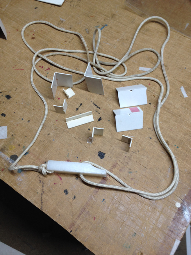

I make these up
