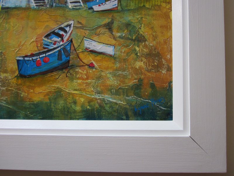

Once again I seek advice from those that have "Been there, Done that, Framed the T-shirt." I often use Tulipwood and paint it. I recently framed a couple of pieces for a local artist who was exhibiting her work. I used a 2" wide Tulipwood frame with a 1" bulllnose slip frame. The customer contacted me a few weeks later, to say all the mitres had opened up (as per photo).I had joined the 50mm wide, 20mm deep, moulding using four 15mm wedges at each corner glued and underpinned at the same time. I will replace the frames, but all I can think to do is reinforce the corners with metal corner plates. Surely this problem has been caused by shrinkage in the wood? So here a few questions I would appreciate answers to:
1). Is it necessary to test the moisture content of mouldings that come from the supplier? If so where do I get information about how to do this?
2). I was using an inner slip frame. I make the slip frame a snug fit. Is that bad practice?
3). How would others deal with this sort of problem from the customer service perspective. I suppose I could have said: "they were fine when you collected them". Replacing two is a costly annoyance. Replacing ten could have deeply dented my yearly profits.
Thanks in advance for your thoughts,
Colin.
Colin.

If you are using air dried timber the answer to question #1, the answer is yes. If you are using pre-milled moulding that is kiln dried, the answer is no.Colin Macintyre wrote:1). Is it necessary to test the moisture content of mouldings that come from the supplier? If so where do I get information about how to do this?
For question #2, there should be a small gap all the around the 2 stacked frames to allow for expansion and contraction.

It's problem I have had on occasion. As you surmise, it's the wood shrinking. Wood tends to swell sideways - that is, across the grain. Most of the time the joint is still stuck.
What I would do in this case is to fill the crack with non-solvented cartridge type glue. Work it as deep into the crack as you can and sand it flush when dry. This type of glue works well as a repair filler and takes water-based paint OK. You'll probably have to recoat the whole liner.
It's a faff, buts as faffs go it's not a difficult faff.
I would also add that when stacking frames it's not wise to make the elements too snug unless they are firmly glued together.

The wood has shrunk and there's nothing you can do about that now. Best thing is to fill the cracked mitres with wood filler and when that's dry, sand the whole surface of the frame smooth again and re-paint.
I've never liked tulip wood especially and I don't know much about its moisture content save for all the recent rain and humidity that some wood in storage is bound to absorb a degree of atmospheric moisture.
I've always found obeche much more stable, so my advice is to repair the frames and don't buy any more tulip.

Did you ask where your customer had hung the pictures? Above a fire/radiator? Is their central heating turned up high at the moment? in my experience non framing people don't think about these things, I also advise people not to leave pictures in their cars while they go off do other shopping.
But I think the crucial thing is that their house heat and humidity levels could be hugely different to your workshop and this is most telling on wide frames, and the framer cant have any control over the conditions to which the frame issubjected once it has left their premises.

Thanks to all, for your interesting and helpful comments. I shall repair rather replace, as I had originally planned. I had wondered about the atmospheric conditions where they were hung. They were in an exhibition, but I have never been to the venue. Of course right above a strong radiatiator could cause problems. In future I may need to quibble my "no quibble" guarantee! Perhaps I will start to use less Tulipwood , which is a shame because I find it cuts, joins, and paints well.

Bit of a bind I know, but you'll probably find if you fill the gaps and repaint the cracks won't reappear.
Metal L plates might be a good idea. Can't beat a bit of over-engineering.
I've seen frames on display in quite prestigious public galleries with corner gaps wide enough to get your finger in.

I wouldn’t use less tulipwood just based on your recent experiences with it. All wood is prone to expansion and shrinkage due to changes in humidity etc. Like you I find it a lovely wood to work with, see all the positive comments about it here http://theframersforum.com/viewtopic.php?f=6&t=11686Colin Macintyre wrote:Perhaps I will start to use less Tulipwood , which is a shame because I find it cuts, joins, and paints well.

I've seen this problem before. Tulipwood is very popular in Devon and Cornwall and when I've been out and about I have noticed this happening with tulipwood, not just on larger frames, but on other sizes of frames as well. It's quite a damp climate around here at times and even during warmer times of the year, the atmosphere can still be rather humid, so that may well be a contributing factor, as has already been suggested.
I'm not aware of any problems with frames that I have made, but I can't remember using any tulipwood mouldings of that sort of size, so maybe this is more of a problem with larger mouldings. In spite of such problems, which are often easy to spot in various venues, tulipwood seems as popular as ever. I'm inclined to suggest a really strong glue, such as Cascamite and to put a few extra wedges in each mitre to make the joints as strong as possible, or even to biscuit join the mitres.
Before the sad demise of Venton Enterprises, I used plenty of tulipwood and now I hardly use it at all. There was not any particular reason for this apart from our stock of tulipwood mouldings declining after the closure of Venton's. We were going to get other tulipwood mouldings from elsewhere, so somehow this never happened. How many frames were affected like this? If it's only one, this could just be an isolated incident and as such not necessarily a pressing reason to stop using tulipwood.
