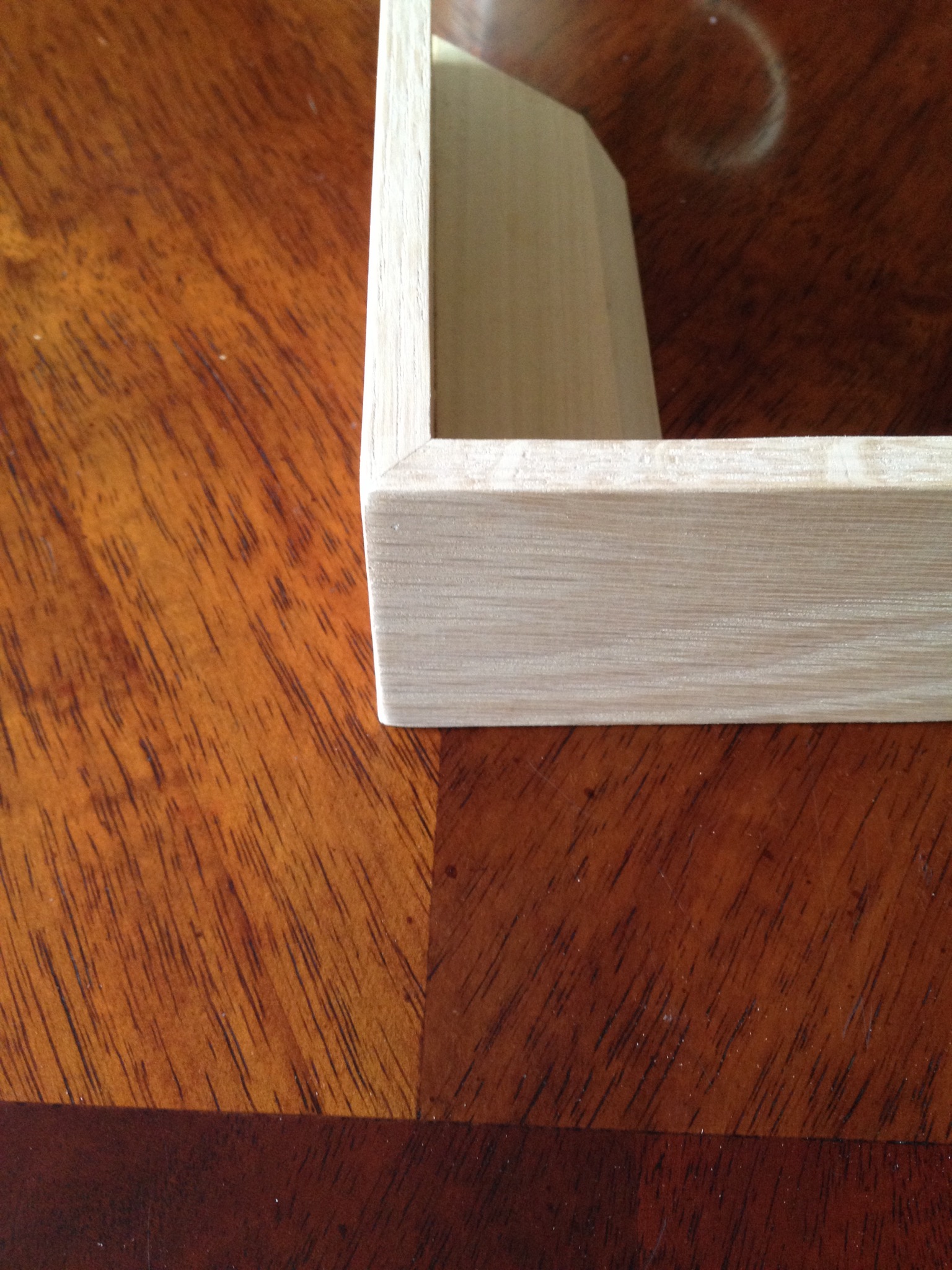

Here is a test piece, for clarification. Is 8mm x50mm oak joined to a tulip base ( it's a subframe profile), glued with a single pin near the top which you can just see in the photograph. The subframe is glued and pinned into place. So far it seems pretty strong. I'm going to make a full frame over the weekend...

Nice job.
Had to look very hard to spot the pin hole.
