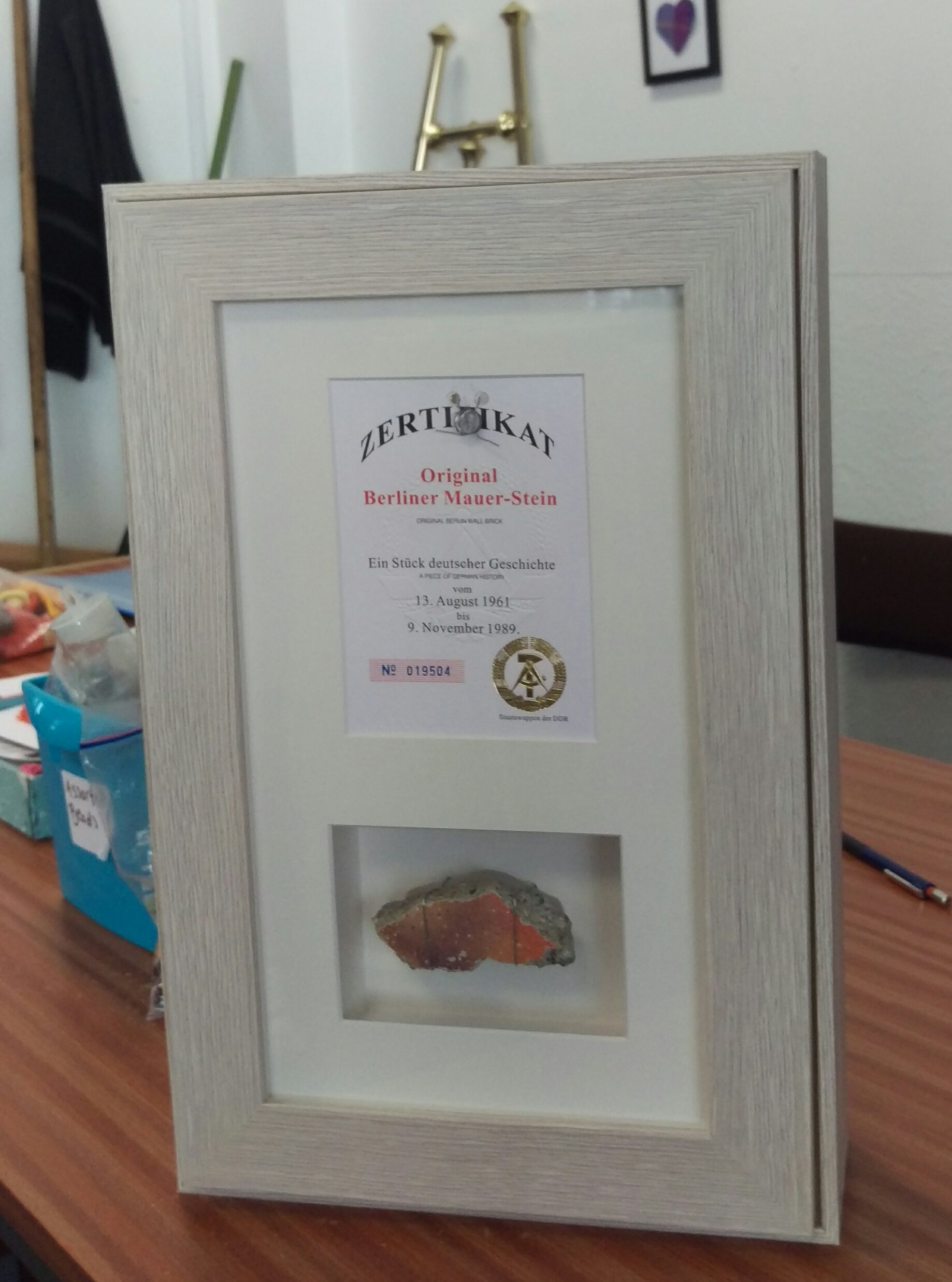

The customer was actually one of my framers, so we were able to get plenty of customer input!
It's probably not how I would have done it for myself, but as long as the customer is happy I'm happy...
Ended up going with thin wire to hold it in place, looked quite nice in the end. You can't really see it in the photo, but it also has a piece of Fimo behind it which holds it flat against the board and also brings it out from the background.
Thanks for all the help with it!
- IMAG0819_1.jpg (362.15 KiB) Viewed 5986 times

It really does look quite handsome. I like the washed grey moulding and the certificate actually is nice looking.kartoffelngeist wrote: ...Ended up going with thin wire to hold it in place, looked quite nice in the end. You can't really see it in the photo, but it also has a piece of Fimo behind it which holds it flat against the board and also brings it out from the background...

I'd lose the aperture mount and put the certificate in the same board the rock is mounted on, the main item is then forward, not behind and with far more space around it.
This way, to me, It's buried.

I agree to an extent, what we would have done is give it a little more space (not much) but put a slight cove in there to lead you to it, each to there own though, regardless it does look good
