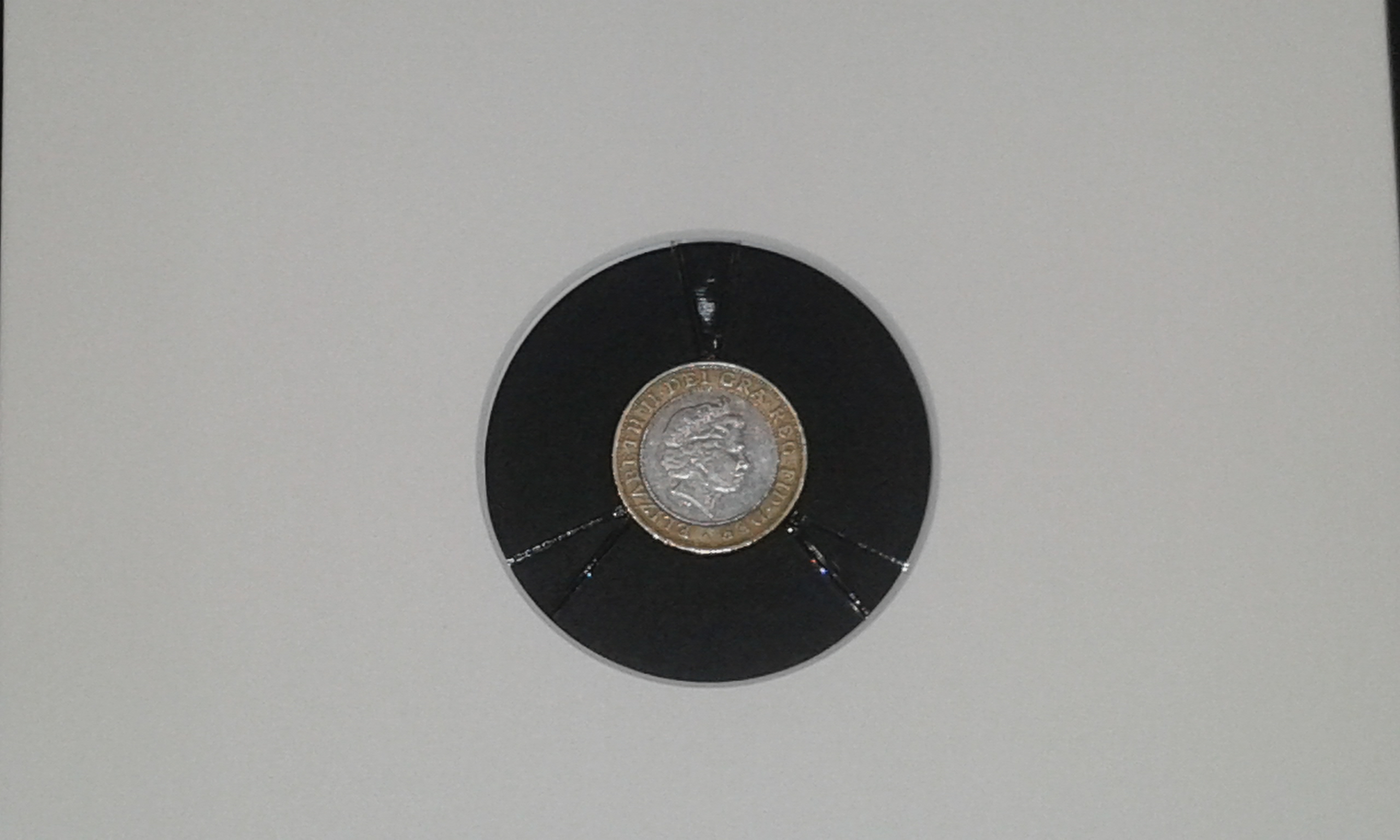

Re: coins - double glass frame
I would most likely go down the acrylic route, but laser cut a holder like this one, this is only a tester, took less that half an hour from designing to cutting, would sandwich the acrylic between two mounts back to back so only the 3 holder would be showing and space the glass off, so it's floating. As I said this was only a tester to see if it would work, so the finished one would be a lot better designed
Just popped a mount on this tester
Perhaps you should read the first post again, both sides and the edges are are to be seen , my photo only has the black there so you wouldn't see the carpet on my bench, the way I have done it is double sided and the edges are in clear view
