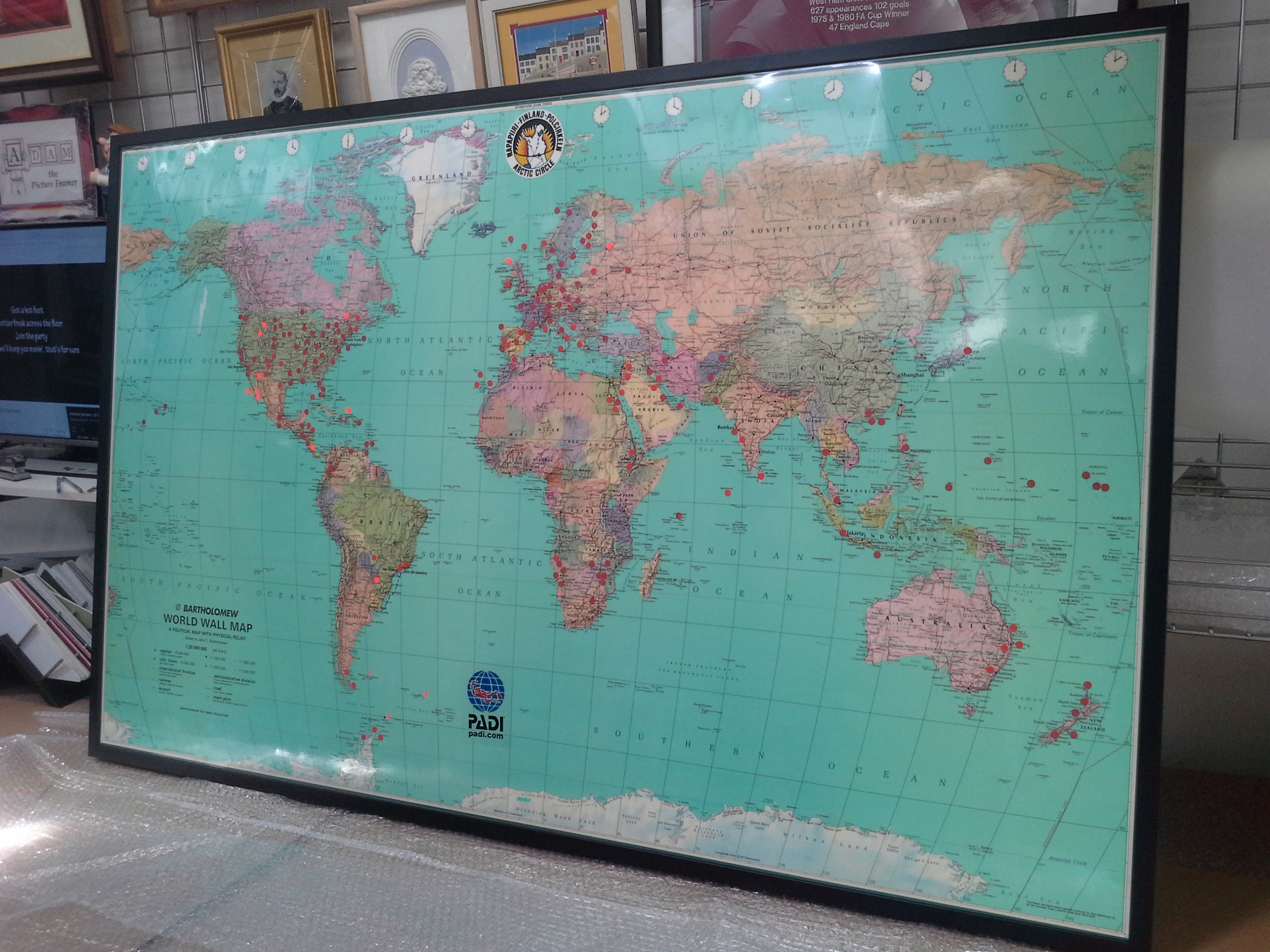

Thanks for the advice people, as I'm often told, 99% of the things I worry about never actually happen, it turned out fine after all that. Not ideal but under the circumstances and i had warned the customer that it wouldn't go down totally flat, I cut a sheet of 5mm foamcore to size and laid lengths of carpet tape down and then gradually unravelled the already laminated map down whilst peeling back the tape a length at a time.
I was surprised how well it went down actually. Here's a photo I took, I backed it with a sheet of MDF and braced it across the back, no glass as the customer is putting red dots on it to show where he's been on his travels, my map wouldn't look quite so impressive ....
Thanks Again,

Re: Large Laminated World Map to stick down anyone ?
Nice bit of work there, I'd never had thought about using carpet tape but in this instance it's quite a good idea. Don't suppose you got a snap of the bracing on the back? (just curious
