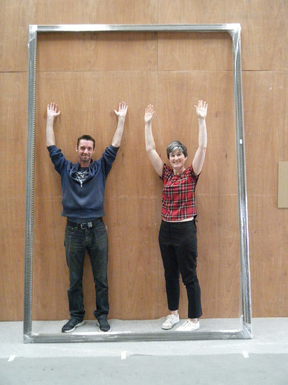

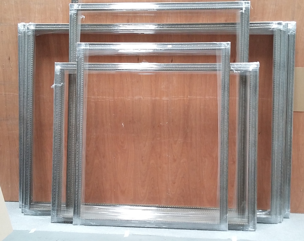

In the end we used this Arqadia moulding.. ......the longest length we got in was 2.965m....so as we needed some framess over 3m , we managed to join them as follows.
We chopped the pieces to be joined in the saw...........one piece correct way round and other turned back to front.........this gave us 2 mating surfaces. We then routed 3 x W2 dovetail slots with the Hoffman router in the "normal" end...........as we would do if doing a regular 90 degree joint...........it then took a while to figure out the settings on the stops of the router to gets the corresponding dovetail slots in the correct place in this "back to front" piece...so that they were spot on to allow insertion of the wedges.
We then glued the joint and inserted the wedges. The result is strong & visually good , but not perfect....(could be improved by giving more time )...........but on this moulding in a large frame, the join is almost invisible...............centainly to non framers at 6 ft "!!!
It would be easier to do this technique on a flat front moulding, as we had to play with the wedge positions to take the profile into account.....compromising position for wedge depth etc.
In this instance , we were happy with the result, which is now quick and easily repeatable.
Yes the frames are big......but were Ok on space in the workshop and door access etc.....However, we do plan on using a furniture removal company to deliver them to the hotel. We are making the "frames " only..which will be placed over a "block mounted" print on a wall.
Many Thanks

Crumbs, those frames are seriously large and it can't have been easy sourcing the glazing for them. Anyone who is not only willing to take on a job like this, but to also bring it to a successful conclusion is indeed worthy of respect for doings so. Great job and nicely executed.

Re: Oversize Frames.......Joining moulding
Very impressive ... also thank you for tip how to join -> 3 x W2 Wedges. I'll test this right away
