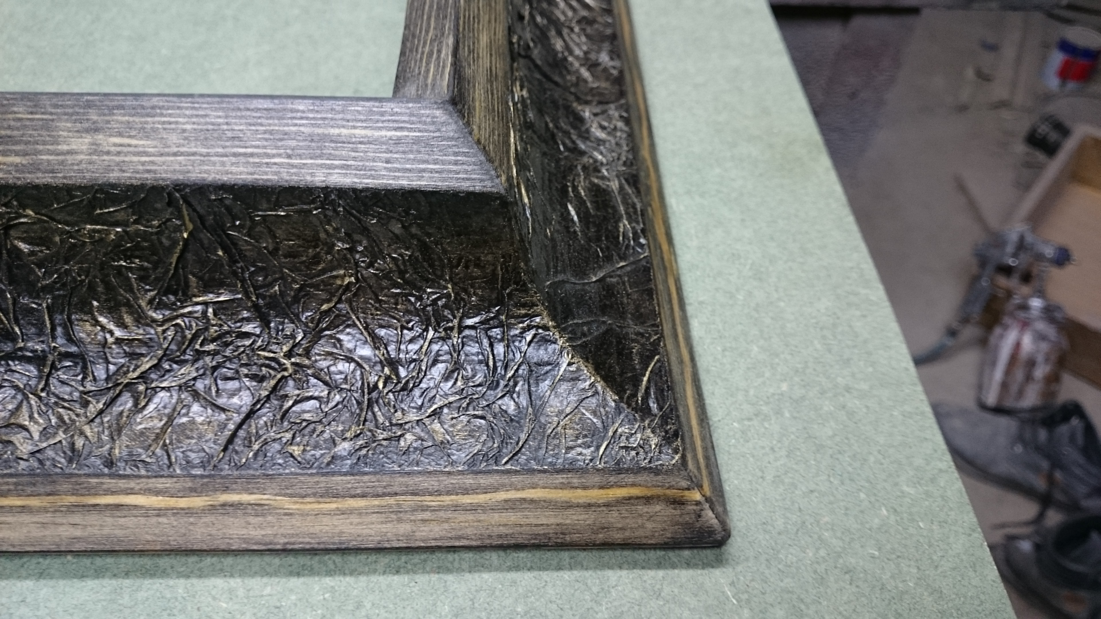

Hello :)
I'm posting again after the amazing encouragement i received for my work.
This is a very unique moulding i made, this frame is made of spruce wood and it's only as a sample, to stay at the workshop, sometimes I fill the curve with gold leaf or color it different than rest of the frame, it depends nor client taste, but many love this special style i made in this frame.
I made it with special specifications and measurements to carry very heavy and thick art work like mosaic art or ceramics, beside any other kinds even it's nice as a picture frame.
Thickness is 8 centimeters
Width is 7.5 centimeters
Depth available for art work is what make it special moulding
It's 6.5 centimeters and possible to make it deeper.
i always make my new designs, and i will share more
Hope you like it and looking for ward to receive your critiques and comments.

That's very impressive. :shock: :D
How did you do the crinkly sides? :roll:

prospero wrote:That's very impressive. :shock: :D
Thanks a lot for your comment, I'm glad you like it :)
I do it by gluing paper sheets and i control the wrinkles, next when it's dry i color it with dark color, then some gold powder mixed with sealer.

Thanks for the explanation. :D
I've seen instructions for that leathery texture on YouTube. Haven't got around to trying it yet.
Pleased to see it does actually work. Love the silvery effect.

prospero wrote:Thanks for the explanation. :D
Glad u like it and i will try to post more in a new thread.
So much you can do with the leathery texture and you will see that in the link,
It's very simple and easy but results is great, so i only paint the frame with white, then using a cotton cloth i spread brown oil color, then wipe it.
Finally a finishing coat.
The link is from my google drive to give you a chance to see the image with full resolution :)
https://drive.google.com/file/d/19Kc_ji ... p=drivesdk
