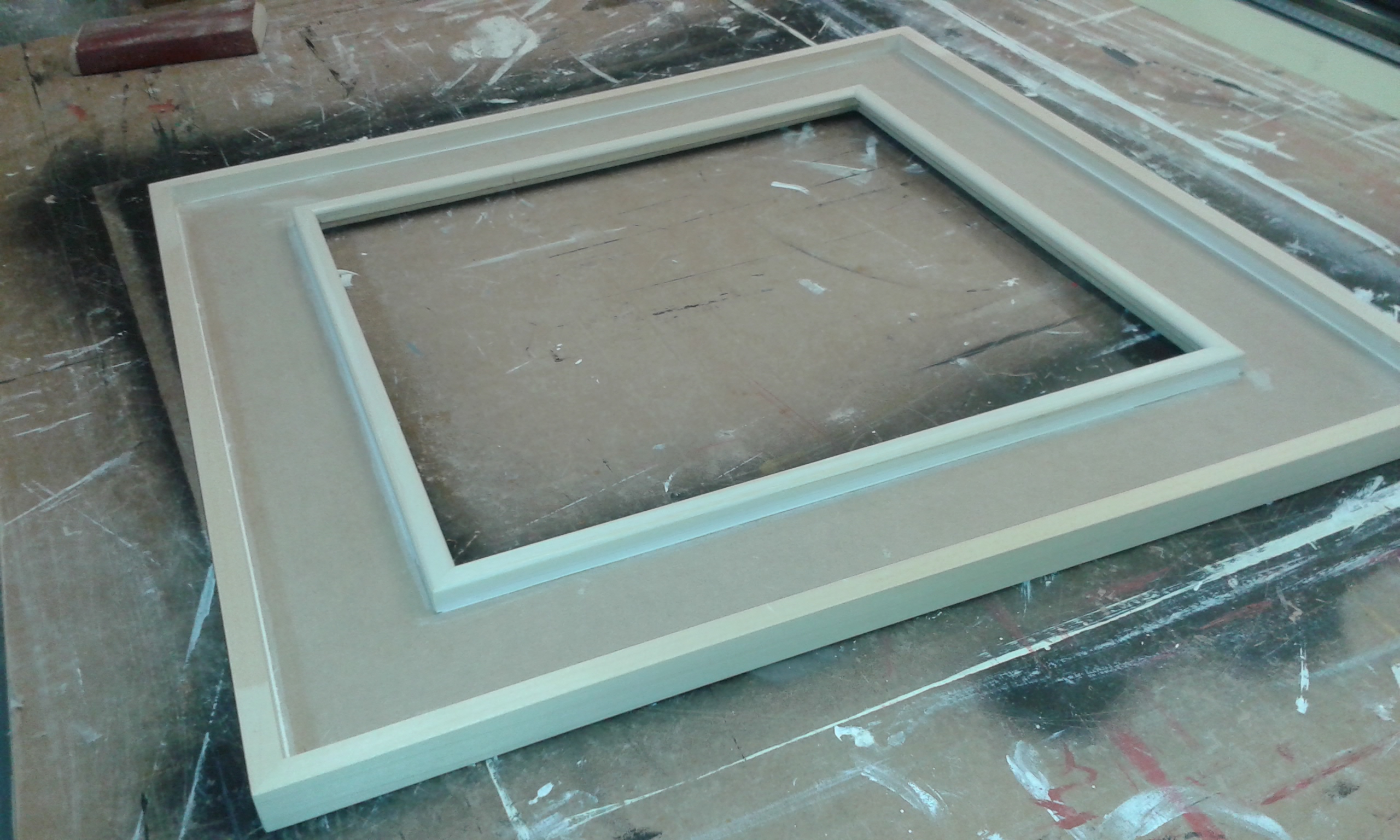

I call them St. Ives frames,
Here is a variation just two frames fitted to MDF then painted, the MDF has a window cut into to it so the (in this case) the painting on board can be loaded/fixed from the back
The outer frame is cut and joined upside down, then the MDF is glued in, the inner frame, is cut in the normal way glued and screwed on the face of the MDF, then all the corners filled , then painted
Use whatever frames you want, it will depend on the size you are making
