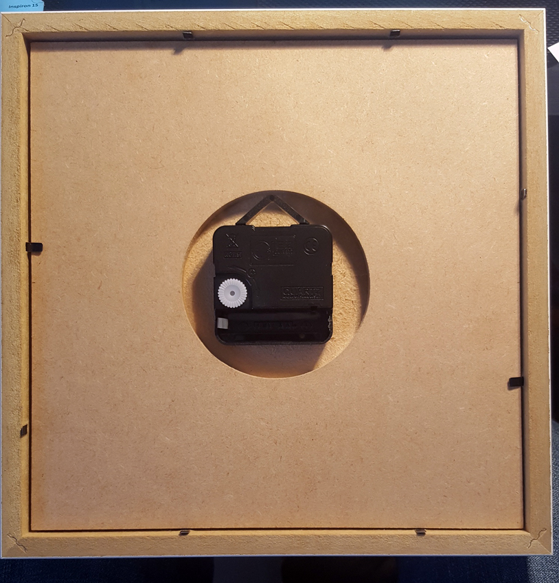

Im working on a framed wall clock made within a deep box frame. I've included 2 x images of the back of the frame. The clock part lies flush in line with the back board and mould and I was wanting it to sit as flush to a wall as possible. The clock part has a hanging feature on it but these are made of cheap plastic and it doesn't feel overly sturdy as the frame itself is quite heavy. I'd like to offer a customer an alternative method to hang this frame so it can still sit as close to a wall as possible.
The width of the moulding on back is a little over 10mm thick. Is there anything simple that I can either use on the sides of moulding or attach to the mdf backboard? Ideally I don't want anything that takes an awfull long time to put together or is too expensive. Customers need to be able to remove easily so as to replace a battery if required.
Any help greatly appreciated.
- frame back.jpg (516.09 KiB) Viewed 7870 times
- frame side.jpg (224.83 KiB) Viewed 7870 times

We use these from Lion https://www.lionpic.co.uk/p/11799/Keyho ... 100-Pieces
Use them all the time for hanging pictures flush to the wall, we normally use 2 per frame, but you could just use 1 to save money, just fit to the centre of top rail.

I think Steve's idea would work fine - of course the two screws would have to be perfectly level on the wall.
Another option would be to use a pair of Wallbuddies. But mount them "inside out" - I suggest this as I see that you have a large recess behind the moulding so that the Wallbuddies could shape inward rather than outward allowing the frame to hug the wall tighter.
Wallbuddies
John
Wallbuddies
John

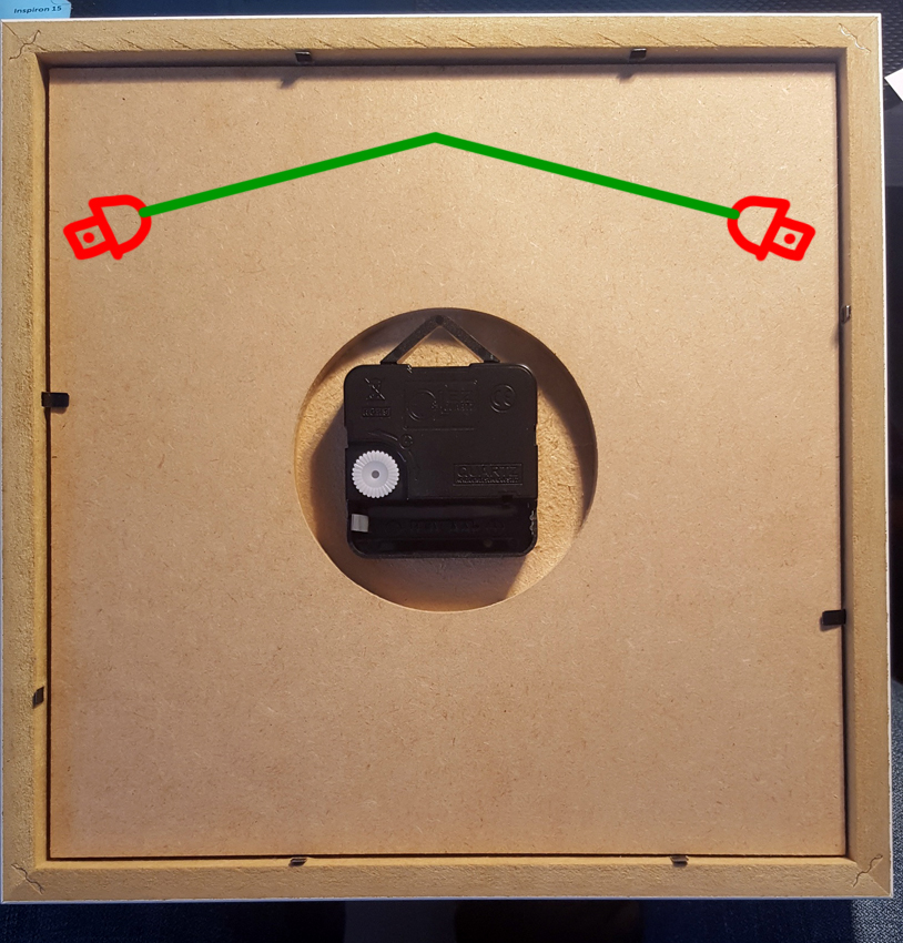

Just do what Steve N suggests and you and your customer will be happy
Just make sure you get the upside down version (not joking)

You say your mdf back board is 13mm thick, do you have some D-rings and cord or wire? 13mm thick is plenty to attach some D-rings directly to the back board with good quality 13mm screws like these. Because the back board is below the back of the frame, when hung on a regular picture hook the frame will sit quite flush against the wall, try it and see
Just make sure the cord/wire is not too slack.
Another way would be to glue a small strip of wood to the top of the back board so it is flush with the back of the frame. You can then attach the keyhole mirror plate to that.
Whichever method you go for, don't forget to drill a pilot hole first
