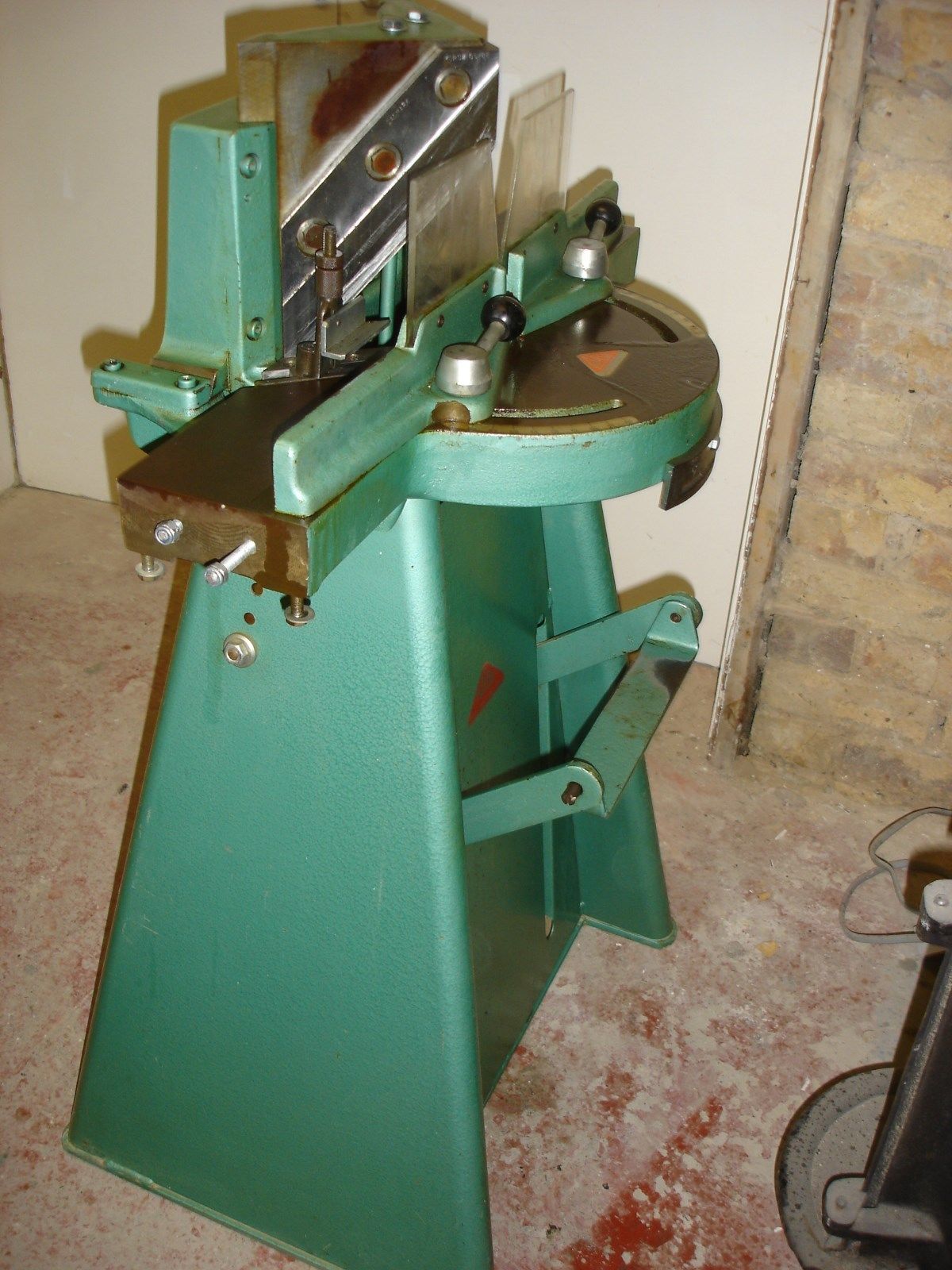

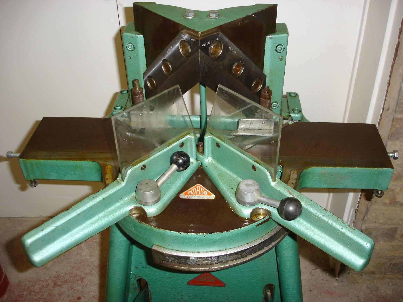

Hi again,
I'm looking around for framing kit and not too sure whats what? Thoughts and advice on this Morso would be greatly appreciated.
Does anyone know which model this is?
It has a right hand side extension also and a spare set of blades.
What age might this be ?
All comments welcome
Thanks, Jim
Thanks, Jim

Welcome to the forum Jim
If you can read the serial number you can check the age of the machine here:
http://www.morso-guillotines.dk/resources/history.html
You'll find the serial number where I've indicated and you'll also see the letter F which means it is a model F, same as mine and many others
