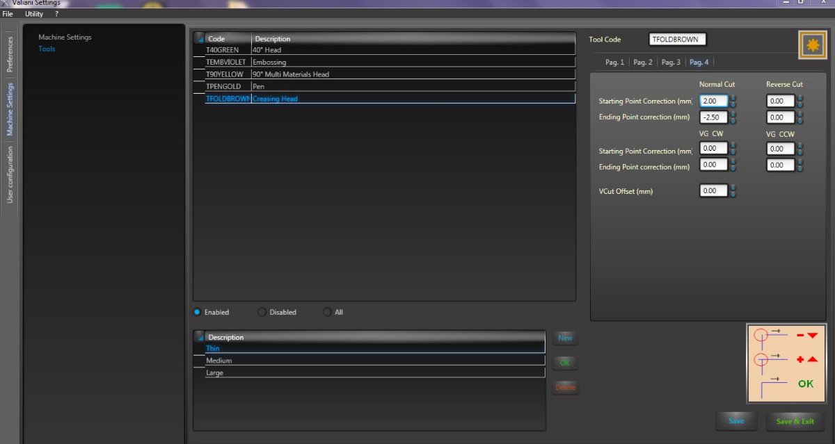

Post by Steve N »
sounds like you creasing head is not calibrated for the machine, you need to go into settings, choose Machine setting then Tools, then choose the tool/head , in this case it's the creasing head, them page 4, top left setting is the starting adjustment, as it shows in the diagram below, if it's leaving a gap at the start, them put in a minus figure (try -10.00 just to see what happen when you run the program) then click Save & Exit, do a test and adjust as necessary
Hope you get it sorted soon

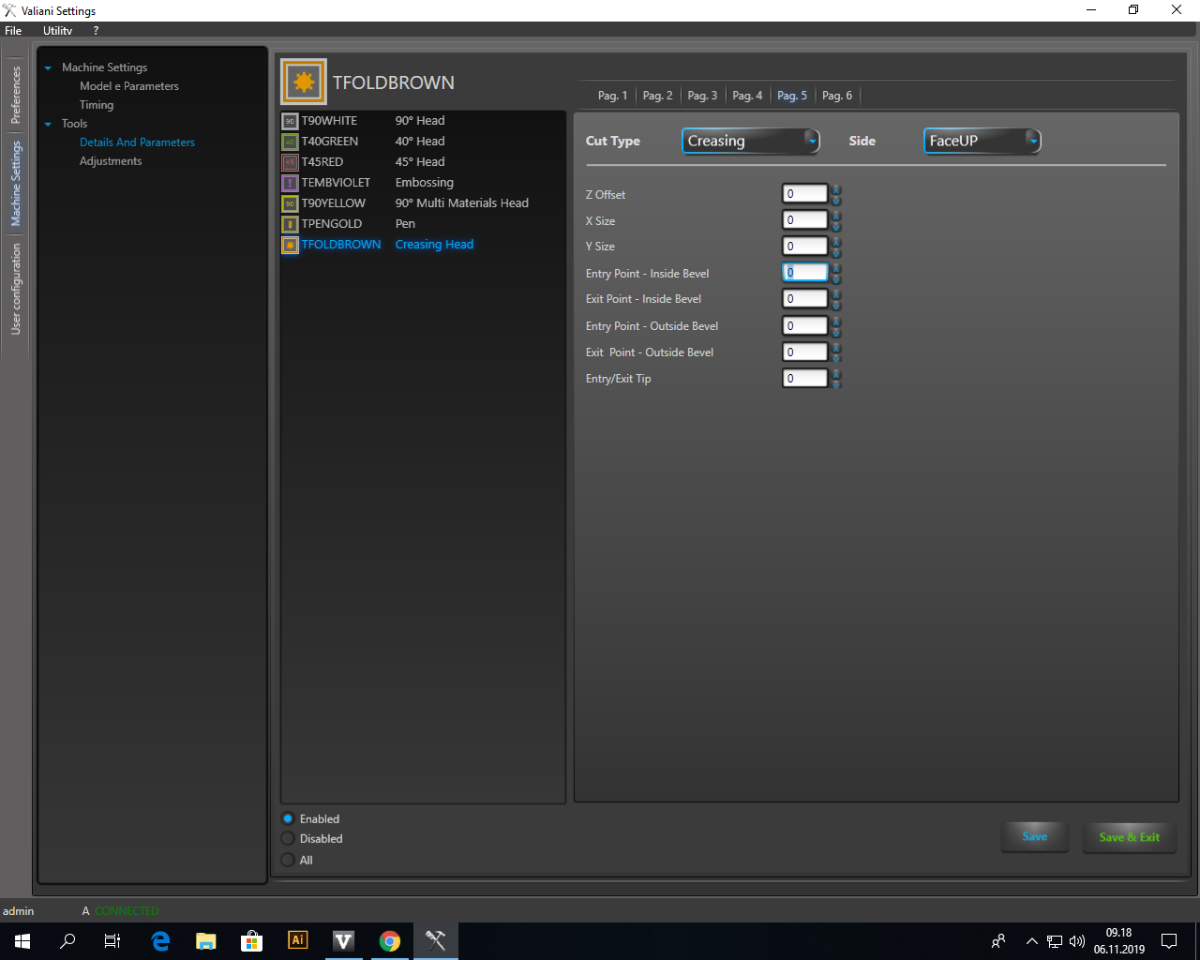

K&G Simon
Posts: 2
Joined: Thu 09 May, 2019 10:40 am
Location: Norway
Organisation: EKKO Digitaltrykkeri
Interests: Photography, grafic design, printing, music and movies
Re: Valiani creasing issue
Post by K&G Simon »
Thanks for the replies!
I don't seem to have the same version of vstudio, but I'm guessing Entry Point is the equivalent to starting point. In which case I've tried adjusting it -36 mm and that did move the starting point of the motion, but with that adjustment it comes into conflict with the minimum clamp distance of 25 mm, which, if I'm not mistaken, gives us a minimum distance of 61 mm. Which is a problem.
The fact that it's not consistent is also making me think that this is not the real issue.
Could it be a hardware issue? Or am I missing something obvious
