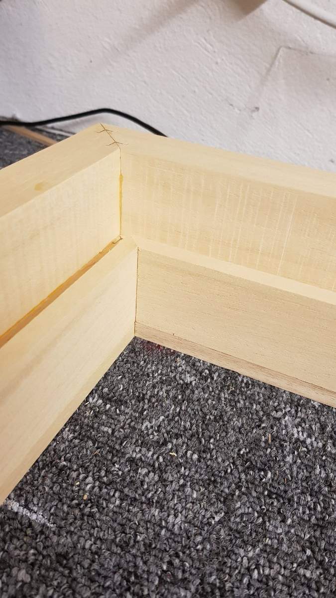

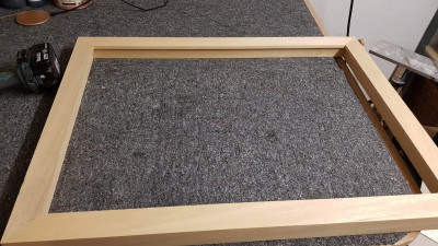

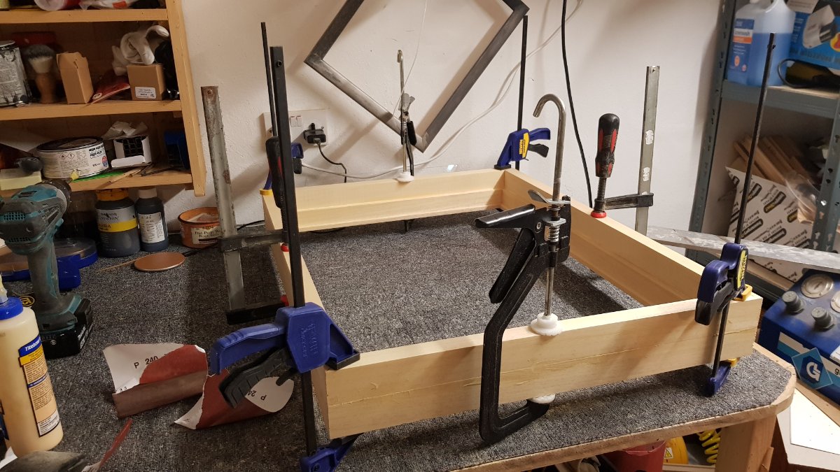

I am having to do a very deep rebated frame for a rugby shirt with a cap. I started today so thought i would take a few pics as i go.
I am using R&H A344, a big chunky moulding with a decent rebate anyway. So first i make and pin the frame

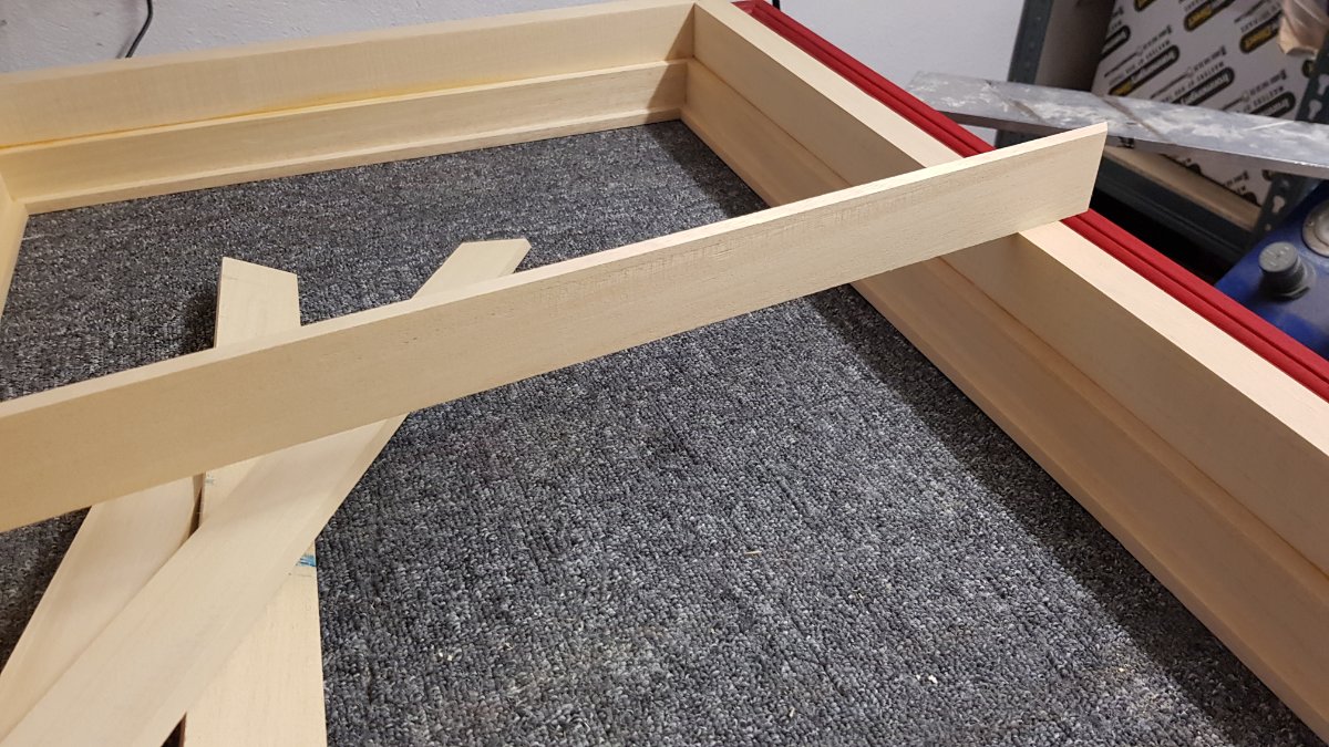

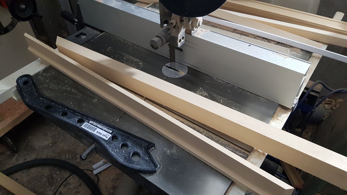

When i cut this frame, i cut a 2nd one exactly the same size. This one i run through the bandsaw. I not only remove the rebate, but cut back about 10mm into the frame itself.

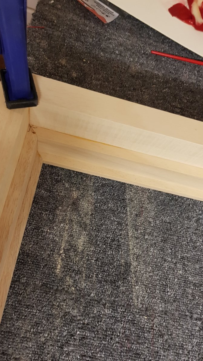

I then pin this together and as i have the time, glue and clamp the frames together. If i had less time, i may have used some pocket screws.
So i now have a rebate for the glass, i will use the leftover piece when cutting the 2nd frame (photo 2) to fit to hold the glass in place and have a 2nd rebate for the mountboard with shirt and cap to sit giving me 33mm clearance from the glass
Will update hopefully tomorrow.
Nick

I found a nice way of blending the two on the outside edge. There is always a bit that stand proud no matter how
accurate you think you have cut. Use a piece of scrap glass to plane it. Better than sanding. One side of the glass
will be sharper than another. Got some pieces of scrap glass have you?

Re: Deep rebate frame
Thanks Prospero,
Gave it a go and it worked well as you said, then realised i use cabinet scrapers which is what the glass is acting as so used that. Happy with results

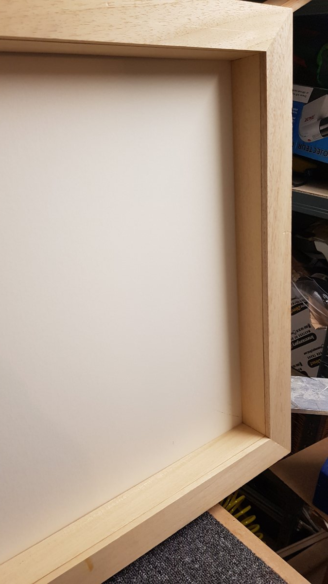

I then took the rebate off the remaining part from the 2nd frame and cut them to fit the lower rebate and fitted in. I decided to not trim the depth so that will give me 44mm of clearance from glass to mountboard.
I am having to wait for customer to come back to decide on frame colour, but just finishing off as normal. I have put an offcut of mountboard so i can place items in position.
