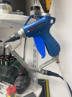

And there was me getting myself one of these and a dry air oil free compressor! Honestly though probably one of the best things I’ve bought - the anti static action as well as the high speed air makes cleaning a job a breeze - it’s sped up that part of the job three fold!
Framerpicture
Posts: 914
Location: Somerset
Organisation: Picture Framing
Re: Air canisters
Post by Framerpicture »
is that an anti static gun Jayvee?

Re: Air canisters
Post by Richard Photofusion »
Oh, that is. Looked into them years ago, but got distracted.
All the man made materials I work with, particualrly Forex Classic, and DiBond are static bunnies, worse still when you peel the release film off.
I need one of those guns in my life.
And some tinsel.
And it would be a massive boon for the scanners - freshly processed film is nice and clean, but older negtives could definately do with a gentle waft from a kilo(V)Bambi.

Re: Air canisters
Post by Jayvee »
Yup it’s an anti static gun!
Cost a bomb along with the Bambi VTS200D. But I’d do it again! I’ve only had it a month or two...not the best timing due to the current situation. That money could have been better spent I suppose now looking back at it - but we obviously didn’t know what was around the corner!
I’ve wanted one for years - and I’ve keep putting it off/forgetting about it/thinking it was a luxury...I think it’s pretty essential now!

Re: Air canisters
Thanks for the response Jayveee, which model gun is that? Its something I've long considered :D

Re: Air canisters
Post by Jayvee »
It’s a Fraser 4125 and supplied power transformer too...not cheap by a long way...but I honestly think well worth it! On the limited items I’ve been able to use it in before shutdown!
You should be able to get them from any clean room supplier - I got mine from Sensemaster in Chepstow.
