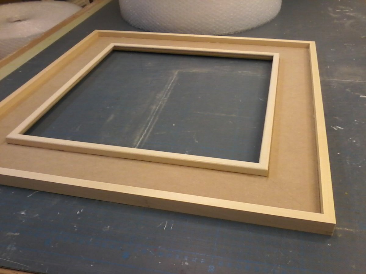

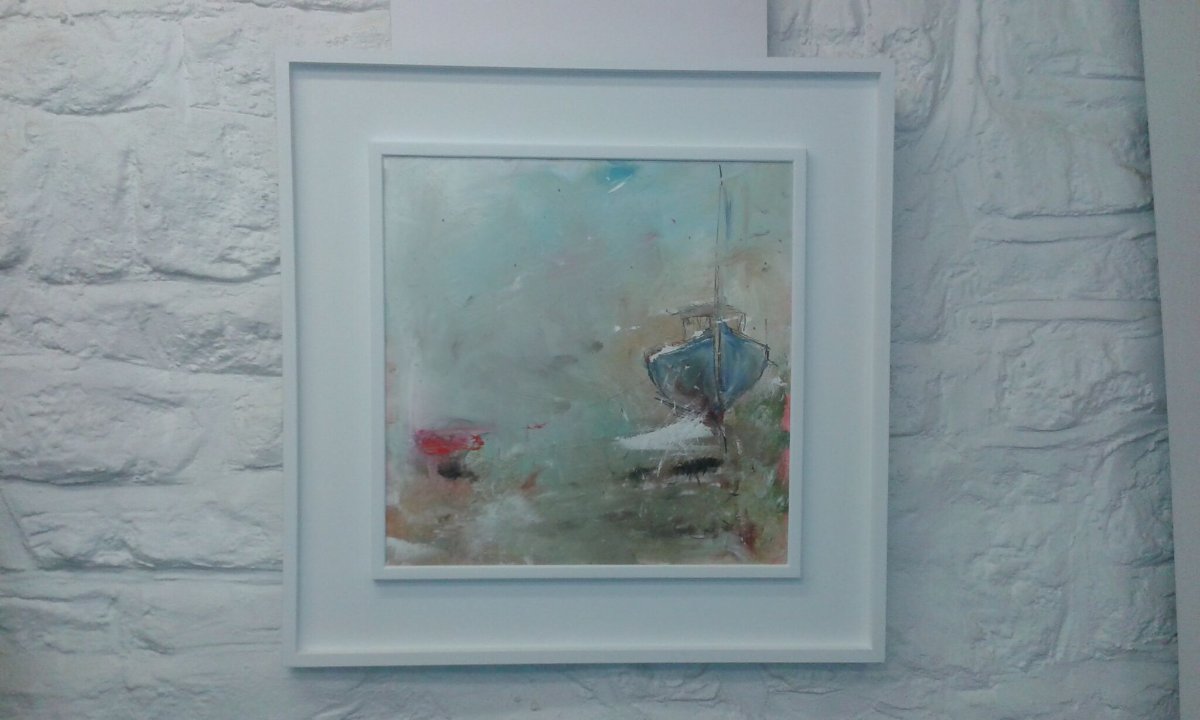

Let's try and help. All of the st Ives frames I make are for oils or acrylics and I have never been asked to make one with glass and boards so I would say the style is more attractive to artists. Although I have seen a number of the Lion mouldings used very successfully for photography.
I Make mine from two mouldings from Rose and Hollis and one from Lion. And I make a rebated and a tray frame version. I'm not that keen on the proportions of the moulding form Lion but apparently it is very popular so what do I know. This is the main reason I make my frame sthey way I do, I took a long time to get the proportions right ( subjective I know). So I have a 16mm outer rim, a 50mm or 65mm field and a 15mm inner rim which sits just below the level of the outer rim.
I either hand paint or spray mine. And it looks a lot better than a factory finish and I have found plenty of customers who are willing to pay.
Where it comes to using glass and board it's just like any other frame.
I hope my ramblings are of use.

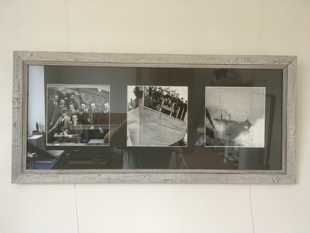

Thanks all for the replies, to give a bit of perspective, I am primarily a photographer but am rapidly finding framing as satisfying. Both my dad and brother were shipwrights, dad often rose at 4 to light the steamer to steam the wood to shape for a new stem. I’ve got an adze (May be spelt wrong but I know what is)in the shed, though if I use this picture framing I will have gone off piste. I am however no carpenter myself, but am learning.
I appreciate all of the feedback, and am pleased that people feel so passionate about what they do.
I have attached a job I did recently to boost my 88 year old dads spirits when he was in hospital. It is a Seine netter he helped build in Grimsby and now hangs on his wall.

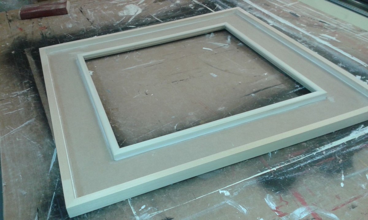

Well then how's about going to Rose & Hollis and making up a St Ives style frame from say F8, on it's side as the outer rail, F9 on it's back as the centre board and A354 as the inner rebate. Glue them together judiciously and join up to make the frame . Paint it white all over and if that's a bit too boring, glue some rough grade sandpaper onto the center flat and paint over that to give some texture and interest.
- Posts: 2994
- Location: Bristol
- Location: Bristol
Re: St Ives Framing Advice
This is the way I do it, sorry can't remember the frame references
An exellent illustration of how to make a St Ives frame.
