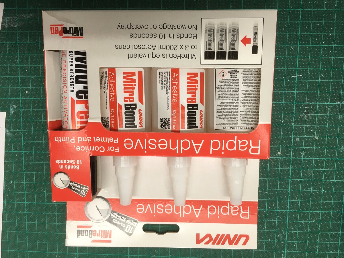

I use this two part rapid adhesive which works really well with no over-spill
