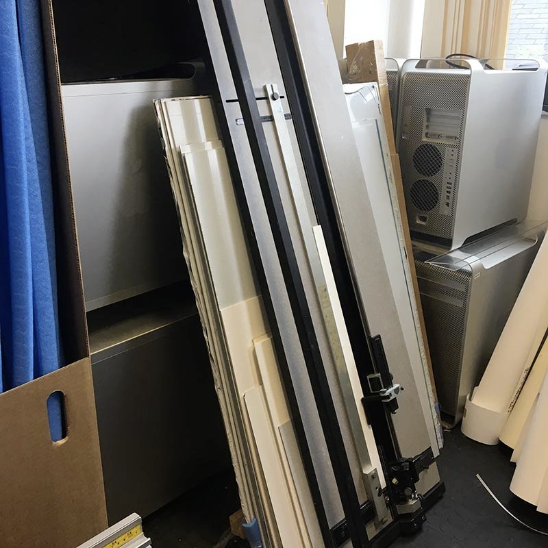

Handywrapped stacks of 2mm aluminium, mostly 5x4", but sets going all the way up to 16x20". Very useful for taming prints from the 44" printer.
Start with corners and edge centres held down by 5x4 stacks, then if the paper is still curly (and some of the alpha cellulose materials are really meant to be springs), trimmed prints held under larger stacks. rewrap when needed.
On occasions (i.e. to bond subframes), I've resorted to using MacPro computers as weights - 19" square, and 25KG. I keep a small stack of them in the corner for such purposes. Weigh distribution aided by sheets of aluminium, forex and so on.
Must tidy that corner.

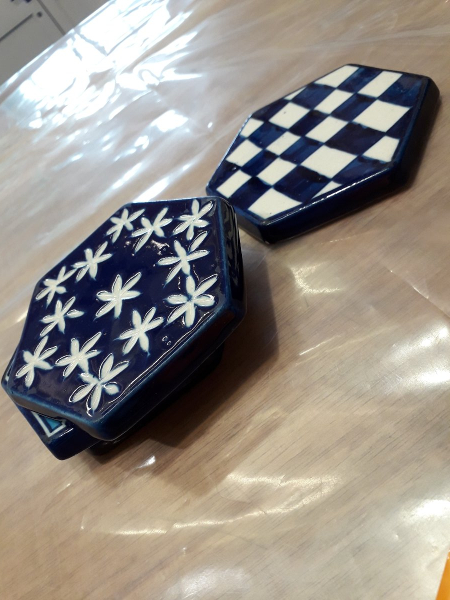

I use ceramic coasters to hold down artwork

Find these in junk shops and flea markets, stick a piece of mountboard on the bottom

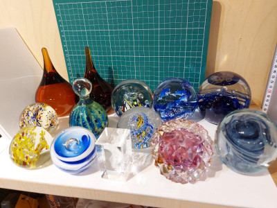

Some great ideas here! I love the reuse of MacPros :lol:
In case anyone is interested, here is my lovely collection of paperweights.
I've been mistaken for a collector, but I promise I'm not buying any more now!

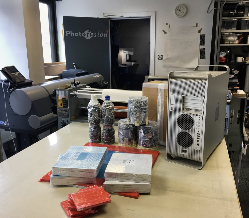

Used blades, still using them for weights as well, while trying to work out what to do with them.
A box of old hard drives - incredibly dense, still waiting to be fully decommissioned before disposal. As they can't be used for anything technological, I guess they qualify as paperweights.
Show and tell...
