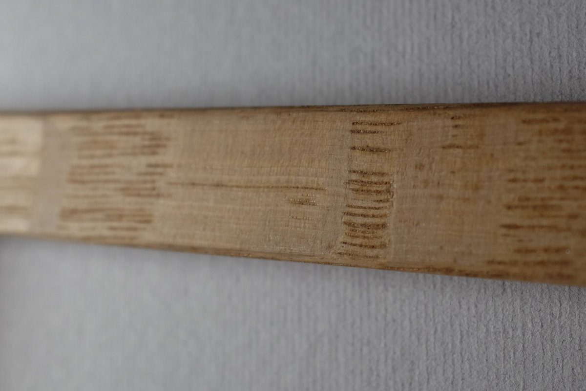

I've finished working through a recent order of oak moulding. There was a bit of 2nd quality moulding. How much 2nds is acceptable from the wholesaler? As it's wholesale am I expected to fill the occasional knot and crack? What about warped moulding?

One issue I find with oak in particular is the patters caused by the medullary rays. I know in oak furniture and panelling these patterns are often regarded as the best cuts, but on a thin oak moulding I can find them a visual distraction, that appear as blemishes. Unfortunately, because they are revealed by an angle of cut in the milling process, it tends to be the whole length affected. Does anyone else have thoughts on this, and perhaps ideas for using such lengths? Or am I being too fussy? Perhaps, like many others, I have been brainwashed by seeing too many perfect oak effect coatings, into thinking unevenness in the grain is unacceptable.

That's interesting that you find the medullary ray pattern a distraction on oak mouldings. I suppose if you prefer a plainer bleached oak effect, then the appearance of these marks can be a bit irritating. One way around it is to sand the surface down a bit more. As the oak ages, the medullary pattern tends to show up more in relief, so re-sanding the surface helps diminish their prominence.
This of course is all the result of the moulding mills slicing up the oak logs so as to get the maximum amount of useable wood against cost. As the saws slice through the logs they eventually expose a plane with all the medullary rays showing, and these are mixed in with the rest of the wood towards the milling process. The end result is that a batch of mouldings will have a random selection of lengths showing the medullary pattern.
However - in fine cabinet making and best quality frame mouldings, the medullary pattern is known as "figuring" and is obtained by the more expensive "quarter-sawing" the oak. Hence the name Quarter Sawn Oak. ( There's even a company called Quarter Sawn Oak! )
With quarter sawn oak, the wood grain is much tighter and shows a finer flecking pattern than with the more open long-grain effect of a plain oak section.
Figured oak was much treasured in Victorian times and can be seen stained and waxed in early oak print frames. The Pre-Raphaelites were especially keen on gilding the oak and always used quarter-sawn sections for their frames.
If you try gilding onto a "straight-cut",open grain section of oak, then the effect is quite brash and horrible, (and how often have I seen this in practice). Laying the gold onto a quarter sawn section, however gives a much more pleasing effect with the finer closed grain and the subtle shading pattern of the medullary rays. Have a look sometime at the flat sections on Watts frames, for instance.
Maybe get to like your medullary rays and the character they can provide to a picture-frame.

Thanks for the knowledgeable explanation of the cause, and ideas for using "figured" oak. I have never discarded any oak due to this patterning, just that I find it a bit unsightly on a narrow frame sometimes. Perhaps I will use it more often, and if the customers are happy then that is all that matters.
