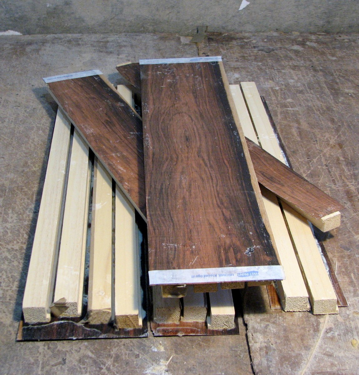

Here I am trying to create some simple contemporary mouldings that can be used around more modern artworks. I've selected a cheap and basic flat top obeche profile - A40 R&H - and glued several lengths on to some sheets of rosewood veneer.
These were glued in a vacuum veneer press - because I have one - but could otherwise been produced using iron-on veneer adhesive or contact glue.
After cutting out and trimming the lengths, I cleaned up the veneer with a basic rough sanding and then milled out a very steep bevel with the spindle moulder. This could also have been done by angling the blade on a bench saw or with a router. These bevels will now be painted with gesso and further water-gilded with both gold and silver leaf.
The look I'm aiming for is a high quality black ebonised finish with a steep reflective gold and silver bevel which can highlight the enclosed artwork.
By using rosewood I have avoided the rather cheap and boring grain pattern found on obeche wood, and instead of using paint which can give a shallow flat finish, I will be layering on coats of black shellac to add more depth and quality to the overall effect.
As well as the black finish, I will also varnish some of the rosewood with transparent laquers and use these as further choice within the range.

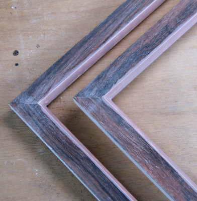

The next thing was to be applying gesso on to the steep bevels.
There are two ways I could have done this. One was to spray the gesso on; takes about 10 minutes to cover the lot. But I would have had to run masking tape along each length to cover up from the over-spray,
So the better option was to paint on the gesso, four coats and that took about 3/4 hour so not much difference either way.
And here's the lengths with the gesso now dried - And that looks nice and messy - but when the gesso is sanded smooth and a quick rub over on to the veneer top, I get back to a nice sharp edge on the profile. That is the beauty of using traditional gesso. It just sands cleanly away where it is not needed.

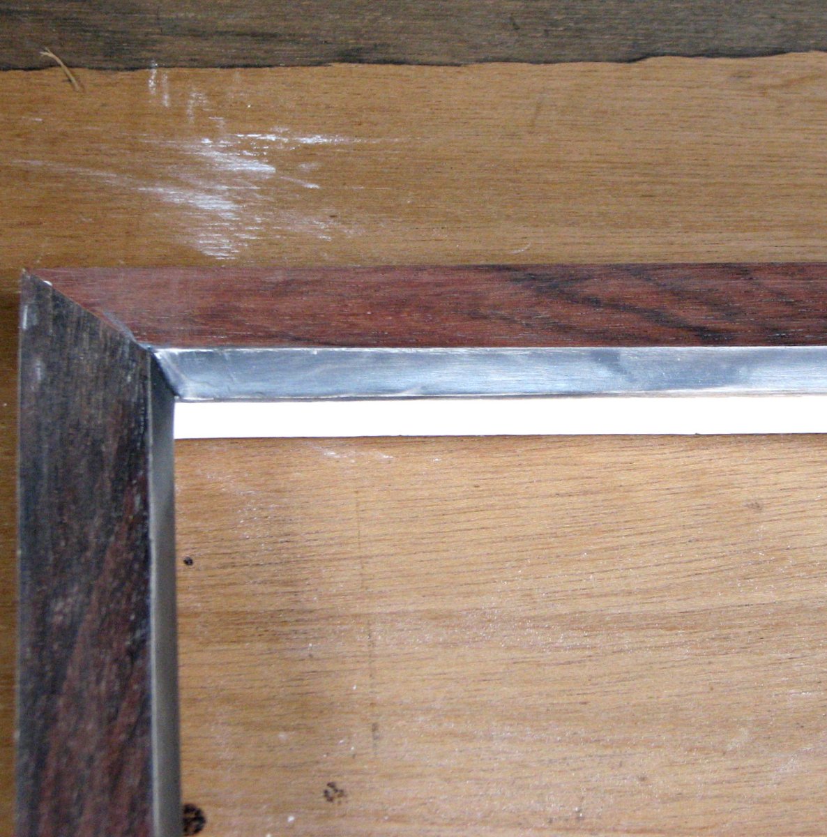

Next thing was to cut and join the lengths. I filled the gesso mitres with some thickened gesso putty. Anyone doing this should first wet the dried gesso, thicken some warm gesso with lots more whiting and thumb it into the mitre corner.
After sanding a bit further, I painted the bevels with gilder's clay or bole. Here again the dried overpaint will sand away when dry. Bole acts as a cushion on which the gold leaf is laid. With polishing the surface can achieve a mirror like finish. So now on to do some gilding ..
