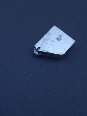

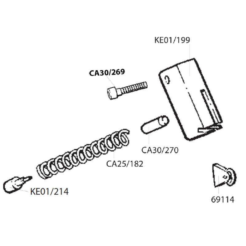

Frustratingly the very next piece of glass I cut broke as per all the previous problem pieces. I've spent the whole day trying to sort the problem. Final job was to clean up the cutting wheel and in placing it back into the turret I noticed that it slides all the way into the turret & doesn't automatically seat in the right place - I have to pull it out & clamp in correct position. On checking the Keencut website I noticed that it's different to the glass wheel they list plus they show several other parts (spring, screw, etc) which I don't appear to have. Below is photo of the cutting wheel part I have - does anyone know if this is correct please ?
Regards,
Neil
This is what I have... This is what is listed...
Regards,
Neil

To answer my own question it looks like I have an early model Excalibur, so glasscutter body appears correct (as the more recent body wouldn't fit). I've tried the new helpcentre on Keencut website but no info there. Please can anyone advise how I contact Oliver at Keencut (who's been mentioned on several other threads) ?
