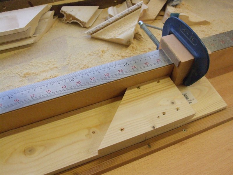

Bit of PAR and a few oddments of timber. 5ft engineers rule. (£25) :D

I bought a Sliding mitre saw so time ago, before I had my stroke. It's not a particularly expensive one, but it seemed like a good choice at the time. It was always in the back of my mind to add some extension fences and perhaps use it for cutting mouldings. Due to my limitations regarding space, there is no realistic possibility of using two seperate electric mitre saws, so I would need to provide some sort of adaption to ensure the accuracy of the 45 degree cuts.
It's not really the ideal saw as it is an electric sliding mitre saw and includes sliding rails, which allow the saw to make 90 degree cuts in up to 14 inch wide pieces of wood. This sliding mechachism is capable of being locked, which may, or may not imobilise an unwanted accuracy issues from the sliding mechanism, but this is so far as far as I have got. Whether things will get any further still remains to be seen, but maybe one day it may, or may not become a working idea.
Another possible option is to make a sliding table saw mitre sled and there are items on YouTube showing how to do this, if anyone cares to take a look. I bought my table saw, not realising at the time, that the table surface of the saw is fabricated from sheet steel and that the running edges in the mitre gauge slot are only about 1.5mm thick. I am assuming this will cause more severe wear on any wooden runner, running in this slot and in time may affect the accuracy of the jig, but I'm still considering this option at some future date.

Using a mitre saw and extension guides is is an interesting idea, if you are also going to do hand finished frames, as if the corners have sight gaps due to any small amonts of variability in the angle indexing mechanism of the saw, a little bit of filling the gaps and hand finishing afterwardswill completely hide any inperfections.
For some framers the idea of using a mitre saw and extentions may be both an attractive and a practical solution at a fairly helpful overall financial outlay. When I am better organised, I still plan to do something similar using my sliding mitre saw and see no reason why I cannot mount 45 degree stop blocks on to the base board so the the rotating angle part of the saw cannot be clamped to these blocks. A wood screw into each of the blocks could be screwed in, or out to accurately set the required angle.
