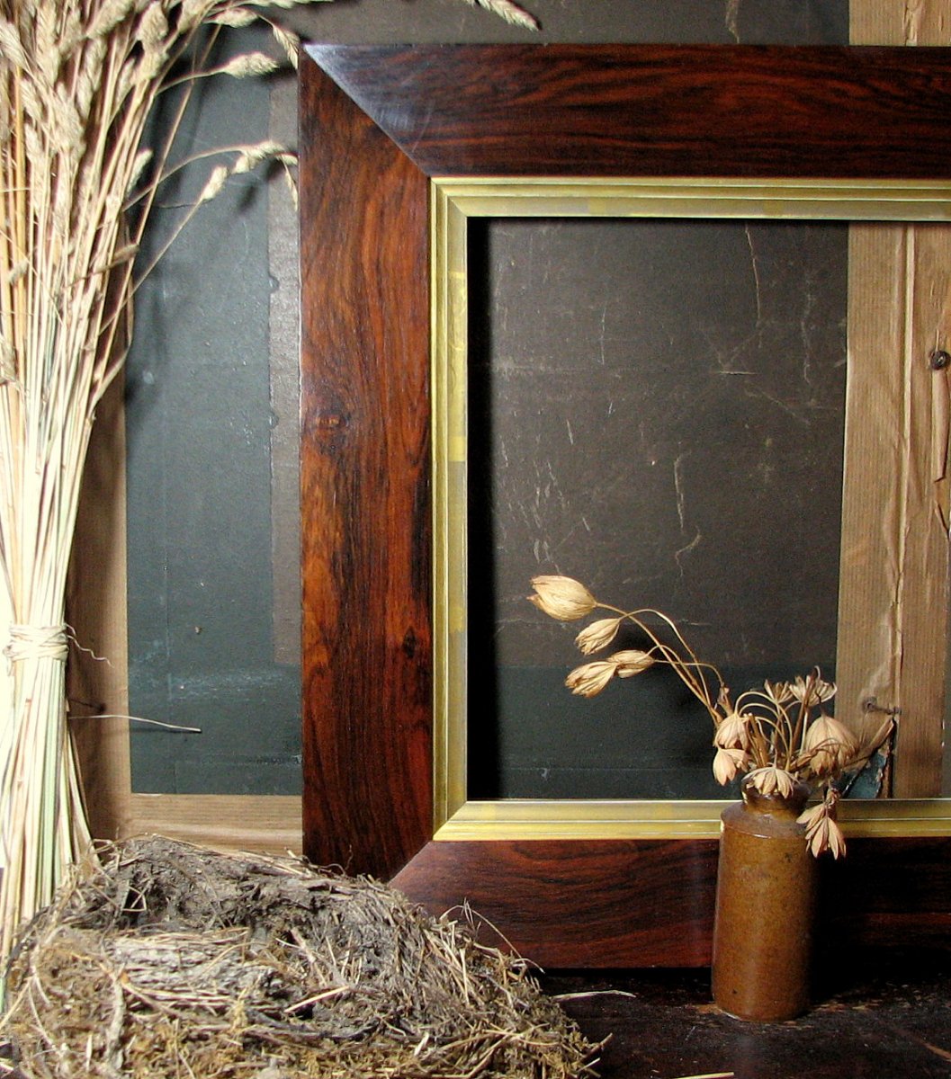

HERE'S ANOTHER FRAME to bore you with.
- Posts: 1627
I suppose you could call this a Gallery frame as it's one of a series made for a gallery and framing customer.
The frame is described as a 3" Sloped Rosewood with an inserted water-gilded slip frame.
Not really a regular high street item but here's how I made it.
I glued together two lengths of R&H pine stretcher (STR2) and then fed these through the bench saw with the blade set at a shallow sloping angle.
The profile was then glued face down onto a sheet of rosewood veneer.
When dry, the entire top surface of the veneer was power-sanded away. This way the full 'figure' and colour of the veneer was exposed.
The frame was then cut and joined to size.
Using a mixture of stains, pigments and transparent shellac polishes, the frame was given a full traditional wood-finish treatment and then polished with a mixture of pure beeswax and carnauba wax paste.
The inserted gold slip frame was made from a length of R&H F10 with twin hollows cut into each side. The profile was then divided and gilded with 23ctgold leaf.
The gilding on the innermost hollow was rubbed back down to expose the bole and left matt so as to contrast with the high burnish on the smaller adjacent hollow.
The gilding was finally treated with a layer of Toning Glaze which was sandwiched between two coats of diluted RSG.
This new Toning Glaze has the effect of diffusing the harsh reflections from the gold and gives the overall finish on the gilding a soft and relaxed appearance.

Thanks Justin and Mark for the compliments.
I'm always happy to answer any questions, criticisms or even derision.

The easiest way to have a go at veneering is to buy from E-bay. There's always someone with a leaf or two for sale.
Then just stick it down with some contact adhesive - best slosh on some shellac or sanding sealer on to the glued side of the veneer first.
After that it's getting to work with the orbital sander to 'clean' it up before finishing.

Sanding wood is so much a part of hand-finishing frames. I clamp the mouldings in an old Stanley workbench and whizz into them with the palm sander fed by overhead compressed air.
A dust extraction hose is best attached overhead from a little Henry but these days I rarely bother. The coarser grit sawdust just gets thrown sideways from the sander and is too heavy to fog into the air and the finer finishing grit tends to remove very little material.

Just ordinary EVOstick Impact glue.
Glue the moulding first, then glue the veneer ( as I said, best seal the glue side first to prevent the glue bleeding through to the face side ).
Leave for 1/2 hour to let the solvents dry off then slowly edge the veneer onto the moulding. Use a piece of release paper as a help to stop the veneer suddenly grabbing where you're not ready.
Rub over the whole thing then with something hard like the base edge of a bottle or a 'veneer hammer' if you have one.
