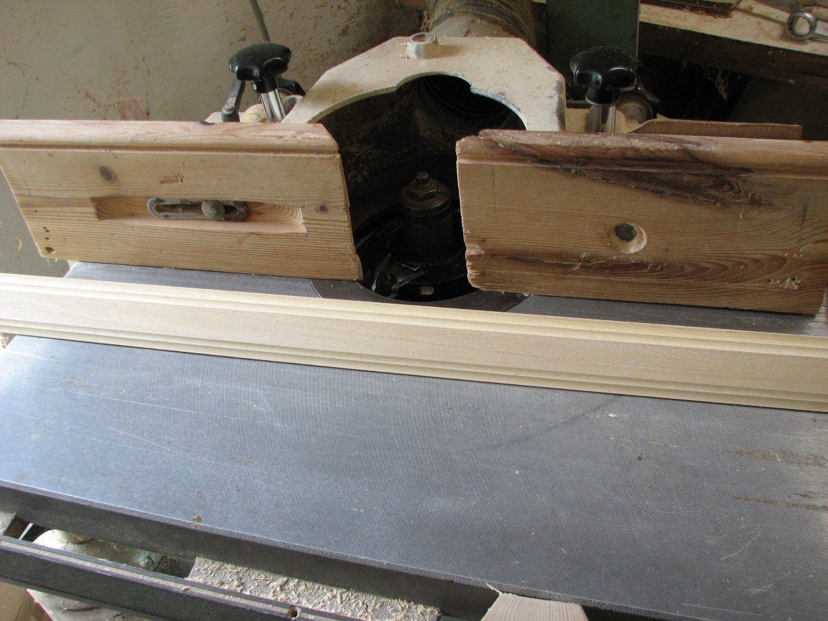

Today's job is to make a quantity of gilded slips for a customer who wants them in 6 foot lengths.
This is to be a 20mm wide double scoop slip of the sort usually seen inside Victorian oak frames and the traditional bird's eye maple profiles.
Even more comtempory mouldings can benefit from an inserted slip but the factory finished 'gilt' slips can look pretty cheap and horrible.
To make these I use the F6 flat fillet from R&H.

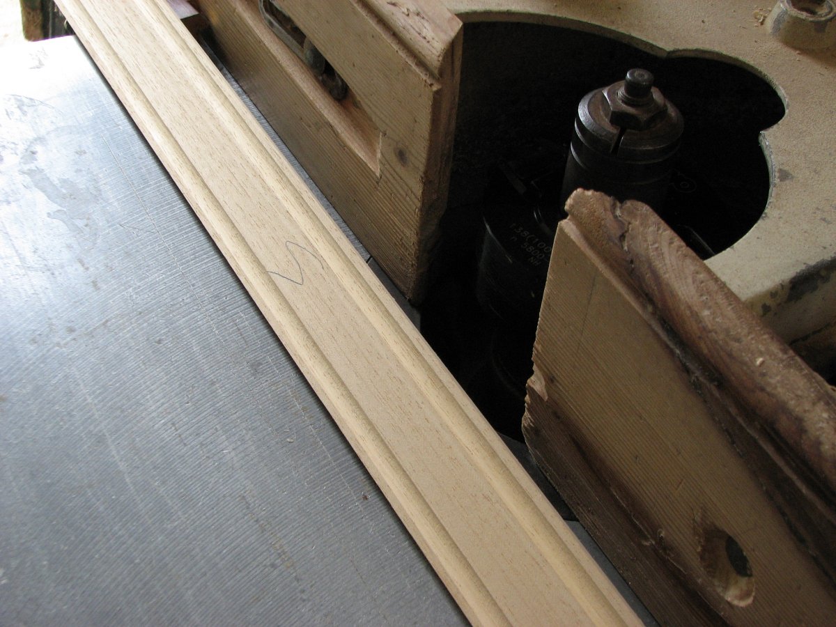

First thing is to cut two 6mm radius shallow scoops on the front face as shown.

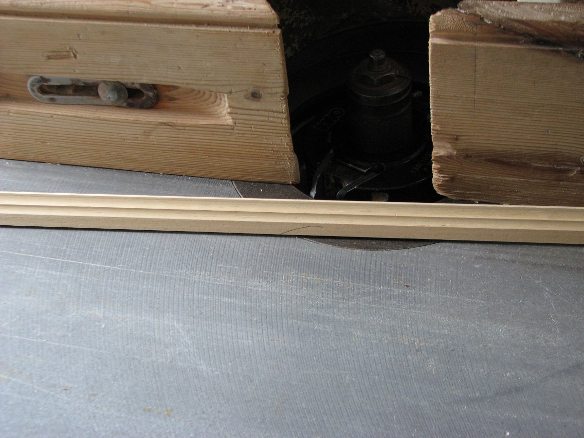

Then follow this with a deeper 7mm radius scoop for the sight edge.
Finally run the fillet through the bench saw to divide into two 20mm sections.
Now it all goes for gilding.

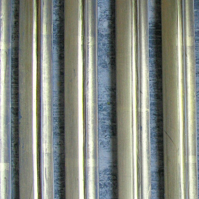

The slips have now been covered with gesso, smoothed back and then given two coats of clay or bole; a yellow undercoat and a grey top coat.
This finish was then washed and polished to remove all trace of any brush marks.
The slips will now be water gilded. That is where the surface is flooded with water and sections of gold leaf are placed on top, so as to float on the water. The water then soaks into the gesso/bole and draws the leaf down onto the surface where the glue, held in the bole, fixes it to the finish.

What do you use for 'wash and polished'?
- Posts: 1650
Re: Making up a quantity of Gilded Slips
That's where the bole is gently washed down with a cotton pad and cold water. Doing this a few times eliminates any brush marks on the surface and then when the bole is almost dry, it can be polished to a very high sheen.
This is a very old technique and is much superior to the modern tendency to dry brush the bole to bring up a shine but in doing so creates even more brush marks.
If you were to look closely at an antique gilded frame you would see no trace of any such markings.

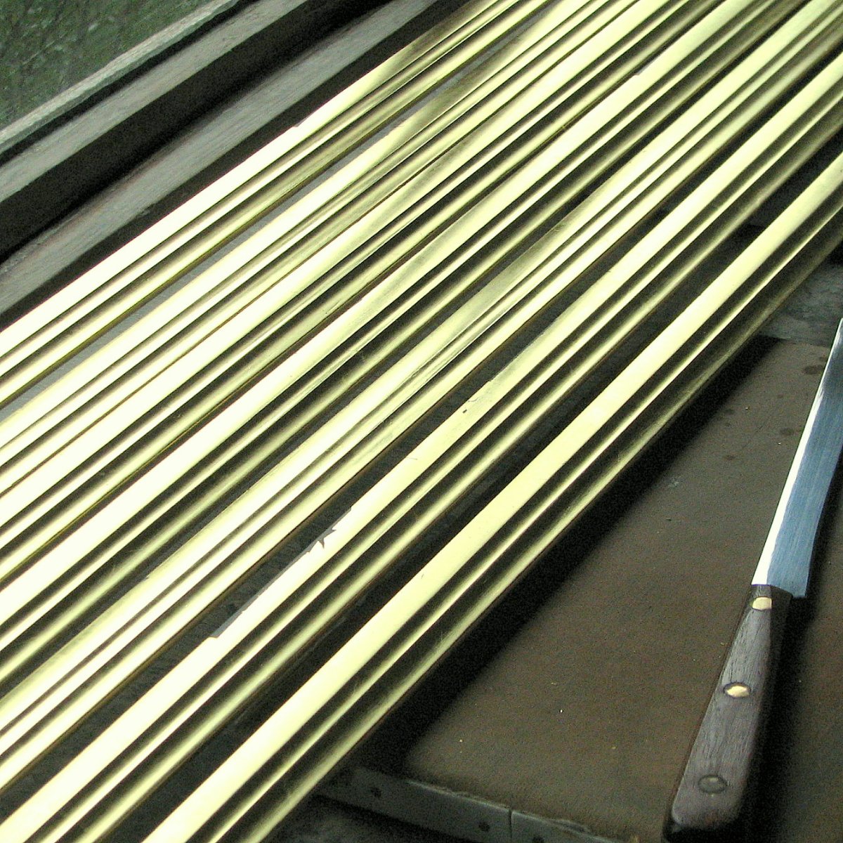

Well that's them all covered in gold.
I covered the whole width of the slips with leaf as it's more cost effective timewise than going back and cutting small slivers of gold to patch up the missed bits (faultings) where I only needed to gild 3/4 the way over the area.
The gilding now lacks any sort of character, so the next process is to 'distress' the finish and burnish up the inside hollow.
- Posts: 1650
Here we are again.
The slips have now been 'distressed and burnished.
This shows three effects that can be achieved with water-gilding.
The first is distressing where the innermost hollow is gently rubbed with fine abrasives to expose the underlying grey bole. This also shows up the characteristic overlaps or lap lines that are associated with water-gilding.
The second is burnishing the middle hollow with a shaped polished agate stone. This brings the gilding to a high mirror polish and contrasts with the more matt finishes next to it.
And the final outer finish is simply described as matt gilding.
Although the slips are now more 'interesting', they are still too bright and shinny to be used against any art work.
The final finish will be where the slips are painted with a Toning Glaze.

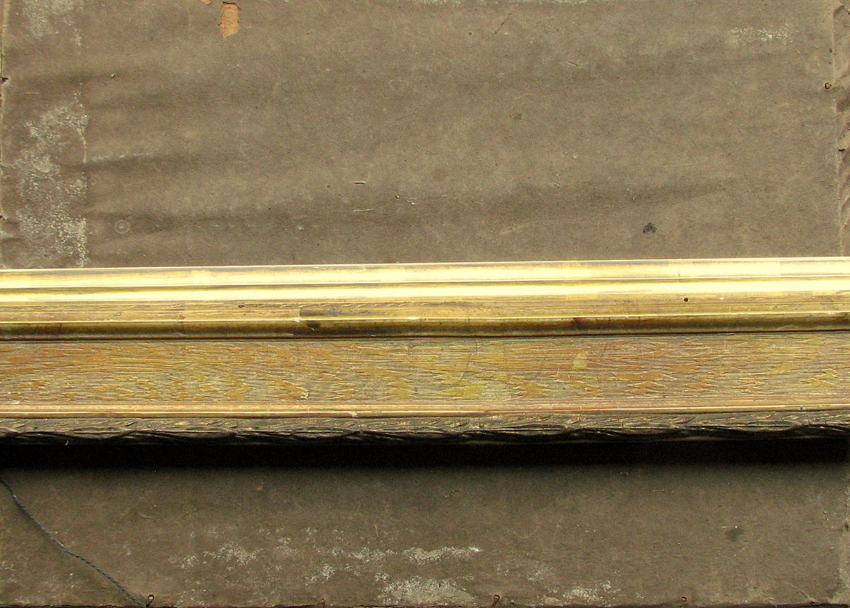

Finally finished.
All the slips have now been painted with my hand-mixed Toning Glaze and given a final top coat of diluted RSG.
The second photo shows the tone match when inserted into an old antique profile.
The purpose of the glaze is not to stain or alter the gold, but to provide a toning filter for the light reflecting off the polished gold leaf.
A fun job. 'Hope I haven't bored you too much.
