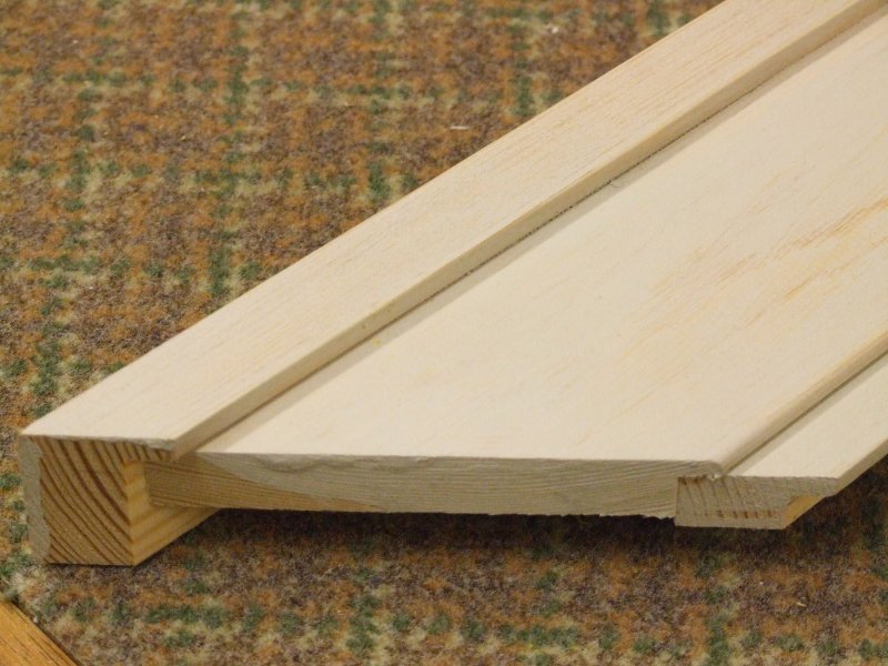

Two pine mouldings stacked and hand finished.
Here's another photo. The mouldings are Simons 0PINE/0028 and Rose and Hollis A10 (pine).
I've only recently bought the Rose and Hollis moulding and today was my first time to use this moulding, I had only just put some glue between the two mouldings and the phone rang. By the time that I got back to the two mouldings thad glue had set, so I did not get the chance to pin them together as tightly as I planed. The finish is oxide red base coat, with a grey wash and this moulding combination is a quite usefully affordable combination.
I want to try a few more colour and wash combinations, as well.

Re: Two pine mouldings stacked and hand finished.
I like the rustic look of this moulding and would be interested to see other colour combinations. I can see that the larger (outer moulding) is flat but is the inner one also flat or slightly cushioned? A wee bit hard to tell from the photo.
The smaller inner moulding is 12mm wide x 12mm deep and in the pine version your will be amazed how cheap it is. The wider outer moulding is usefully cheap too! A much easier finish would be to just do it all in one colour. For me the cost of the materials and producing frames from this combination is a real big deal. There can be a really good price differential between the cost of producing this and the potential selling price. It also has quite attractive and fairly generous proportions, so even with a really helpful mark up it does not seem expensive.

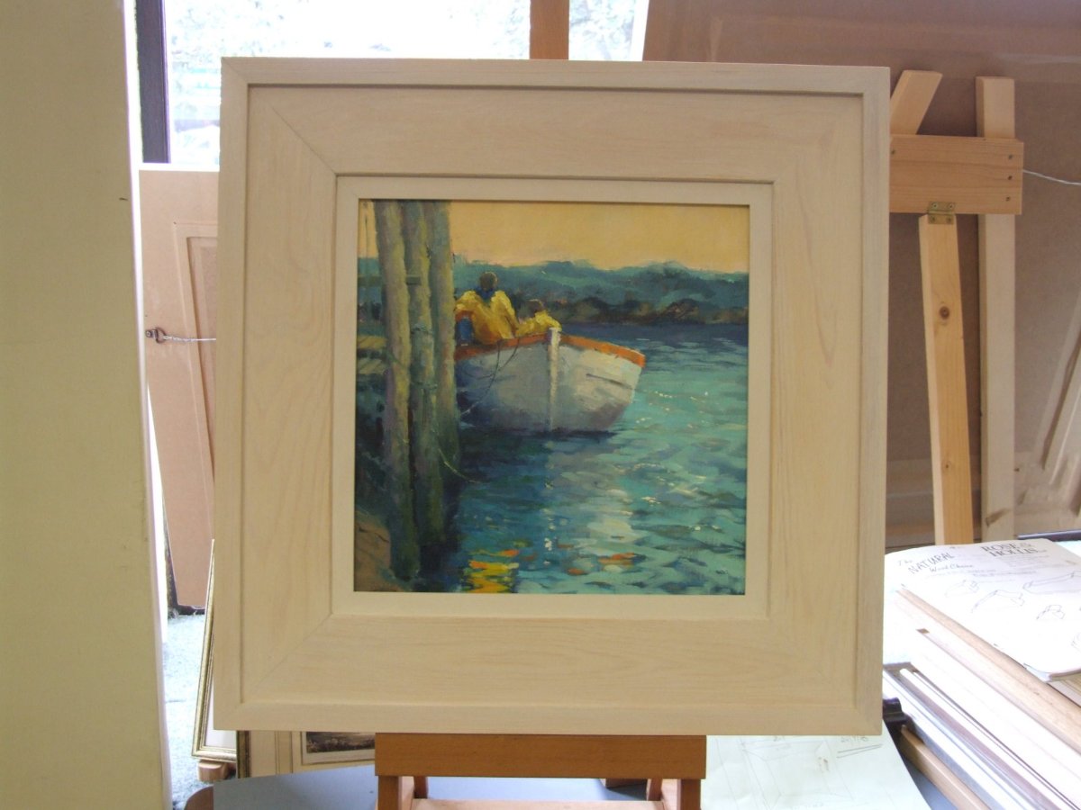

Using three square mouldings is very effective. It's all in the proportionate widths.
This just has a coat of pale shellac and a dragged wash of white ripple paint.
Hi Peter,
I do something similar, but I suspect that yours is a bit wider than mine. My middle moulding looks a bit narrower than yours! I like the two moulding version, because the material cost is really low, but it looks like it oucht to cost more!

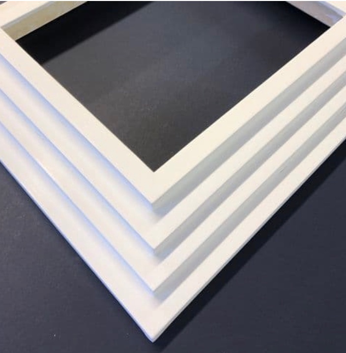

Here is something I made earlier..this one steps
Outwards and down or upwards and in….
Hi Alan,
Yes, I like that! I have a massive chevron sample of something along the same lines, except mine is black over a textured oxide red base coat which has been lightly distressed to let a little of the red show through. Frames like this can create a very dramatic result, where the artwork will work well with this sort of frame. I don't need much pursuaing when it comes to dramatic art deco frames! I'm a real big fan of stuff like this.
Love that frame Alan. Very effective.
