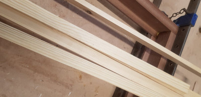

If you want wooden spacers at 10mm, i was literally about to chop these up for firewood. I had them on my chop saw when i remembered my coffee was going cold and had a look on here.
By chance they are 10mm. You can have them for postage if any good? I am having a quick clear up so chucking a load of timber before drowning in it.
Nick
Nick
