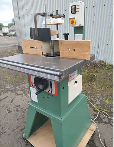

First in is the Spindle Moulder.
Here's one I saw on E-bay for £600 ono. It's the same as the one I use.

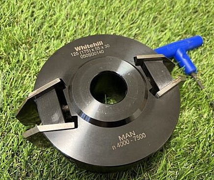

This is a very simple machine where you have a vertical shaft which spins at high speed. Attached to the shaft is a 6" dia. solid metal Universal Block and this is used to hold a pair of shaped cutting knives.

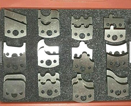

The knives are quickly interchangeable and you can access a total of 180 standard profiles.
Knives come in at around £25 a pair with Limiters. The limiter limits the amount of skin you can take off your fingers if you're a bit careless in your work.
And for around £50 you can have knives made to copy any given moulding.
Apart from the on-off switch and the adjustable fences on the spindle moulder, the big black wheel is to raise the shaft/cutter head up and down.

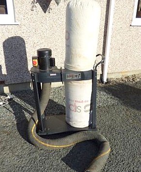

To use a spindle-moulder you will next need a chip/dust extractor.
I saw this on E-bay for £90

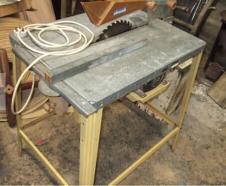

The final machine to have is a bench saw. I've been using a builder's site saw for the past 30 years and here's one on E-bay going for around £40. It's best to look for a sawblade dia. of at least 30cm.

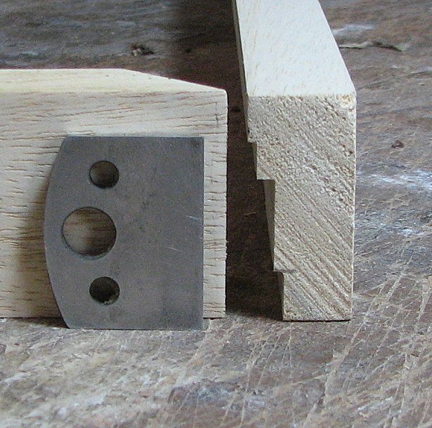

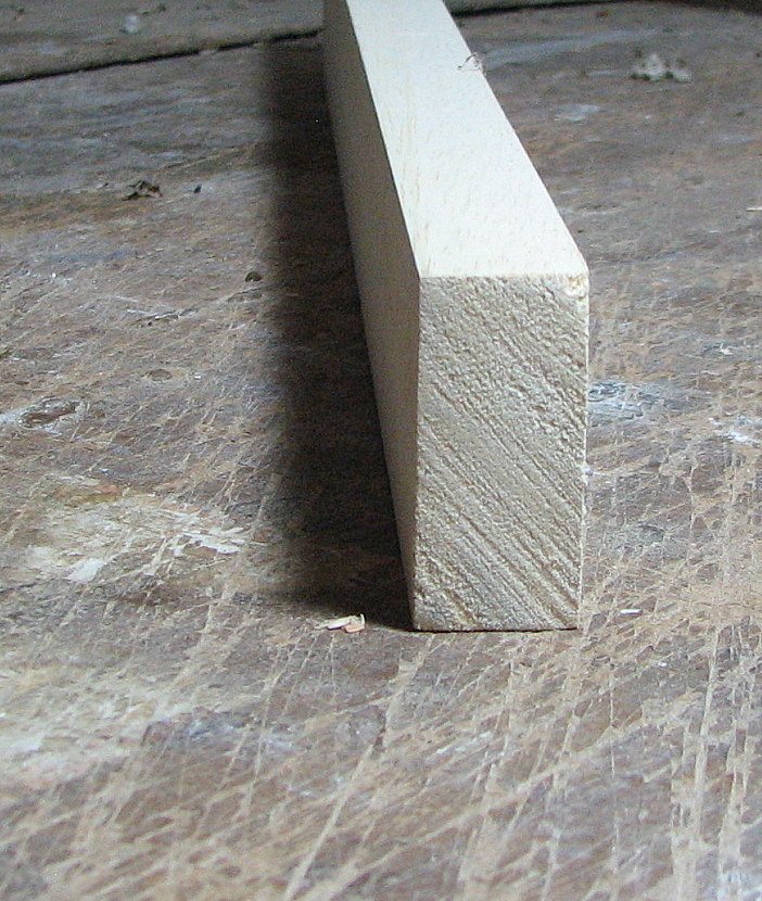

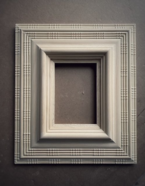

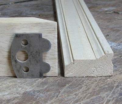

I've taken as an example a length of R&H F8 obeche.

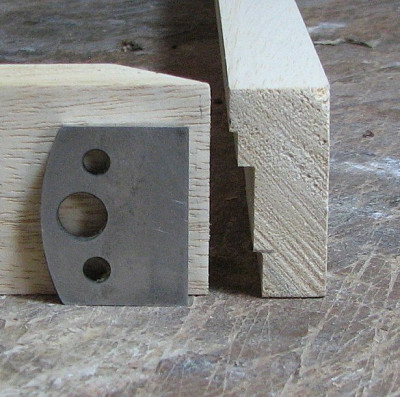

Using a simple 'rebating knife' I have cut into the profile as shown.

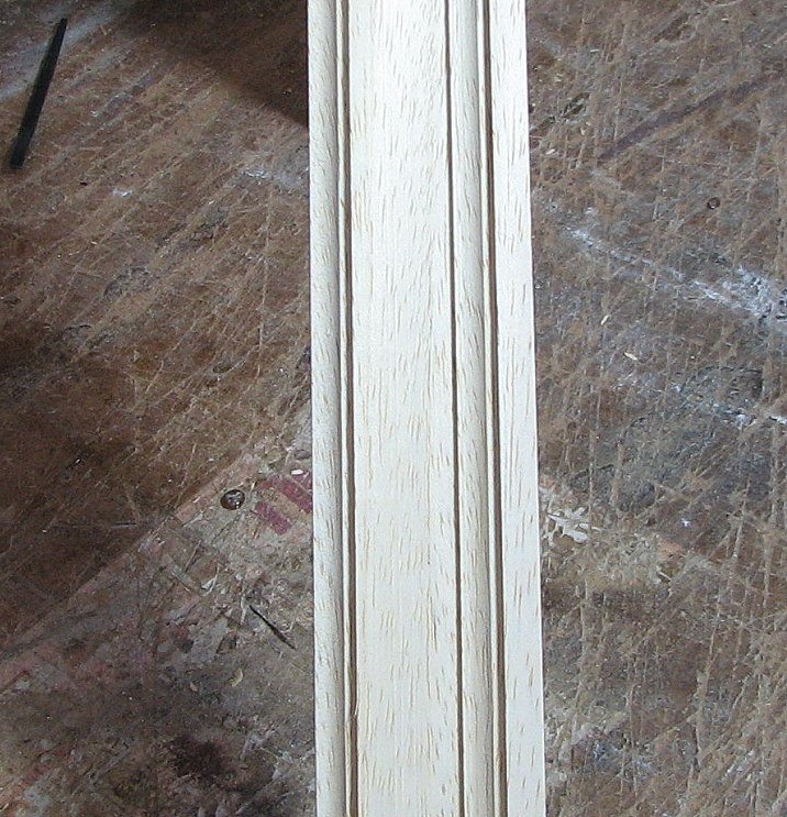

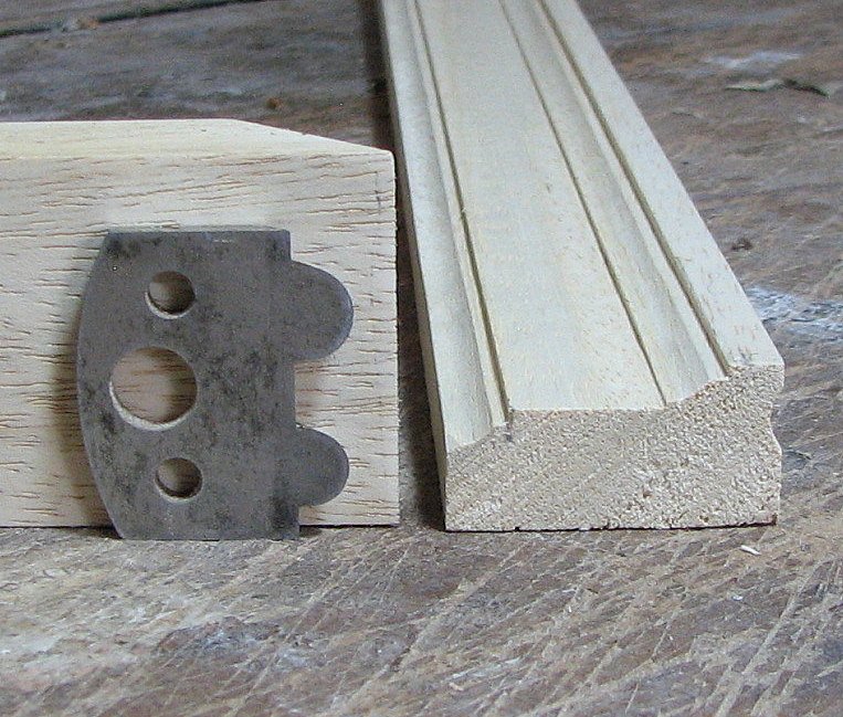

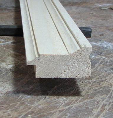

Next, I have used a twin scooping knife to create a hollow sight edge, a surface detail and a hollow on the outside wall.
The profile is then given a rebate to finish.

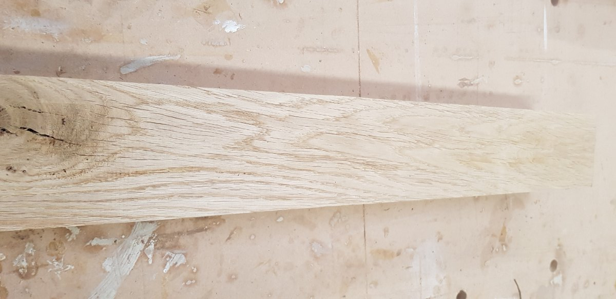

Very useful information. As you mention, like Timh, i machine my own mouldings. It was initially by accident that i took this direction as i agreed to make some very large frames (4m x 3m) and purchased some basic machinery like you posted. Things developed from there and my setup is different now.
The R&H obeche fillets are brilliant for machining mouldings. I believe obeche is very hard to get in the Uk as rough sawn timber. 2 James Latham depots stock it for specific customers, one being near me by chance.

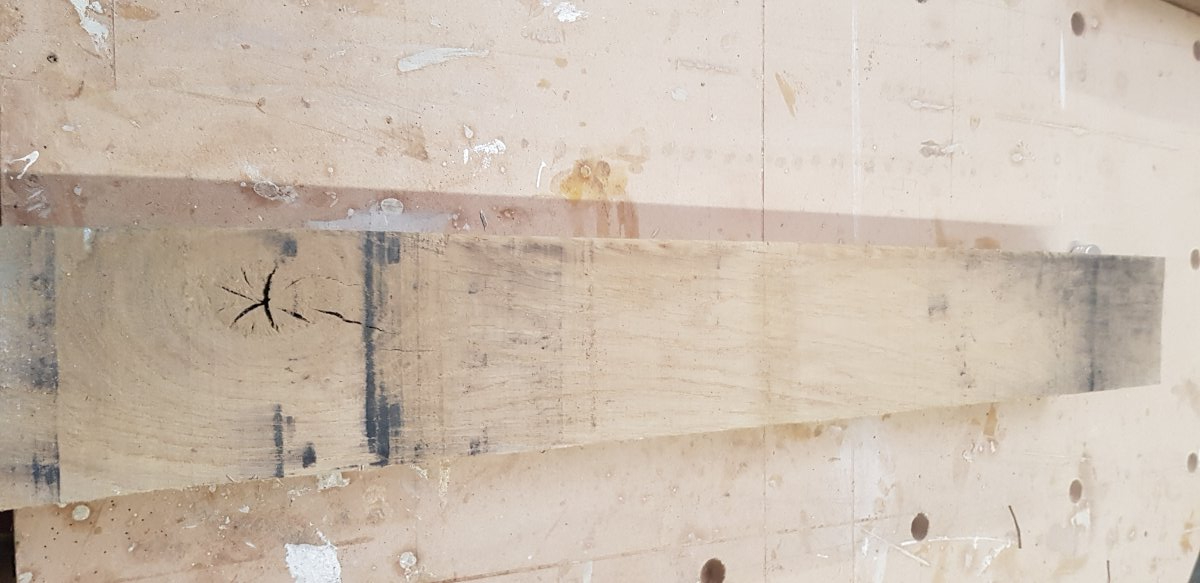

Once you get those machines and find you are hooked, you can start machining your own rough saw timber. For this, you can justify buying another toy, a planer thicknesser. I started with a £500 second hand Axminster machine which did me proud. You can then buy rough saw timber and with a table saw and planer thicknesser. Below is an offcut of oak i used for a job.
One pass through on the planer and it looks like this
If you do go down this path, tulipwood is a good alternative to obeche if it is going to be painted. The other thing to point out that the quality of the pine you can use is entirely different to pine you find in the likes of b & q or even travis perkins. There are 9 grades of pine, B&Q uses grade 7 at best (what they call redwood). Stuff at travis perkins and jewsons is better at 5 or 6. I have not come across grade 1, but i use grade 2 from a local timber yard and it is like a different timber. I tend to get 4.5 - 5 metre lengths This is 2.5 inchs thick and a 4.5 metre length would cost you about £52 plus VAT.
So, with a planer thicknesser added to above items Dermot showed, think how many lengths of mouldings you could machine from that.
The added benefit of the above setup is that if you wish, you have the kit to start making other things, even if it is for your own home. I started by making my own door and a friend cut the mortices for me. From there, i started getting asked to make some doors and then windows. But another easy item to make without a morticer is kitchen cupboard doors, so you can freshen up a kitchen for a fraction of what you would pay. The point is, these are bits of kit that give you the opportunity to do far more than make mouldings.

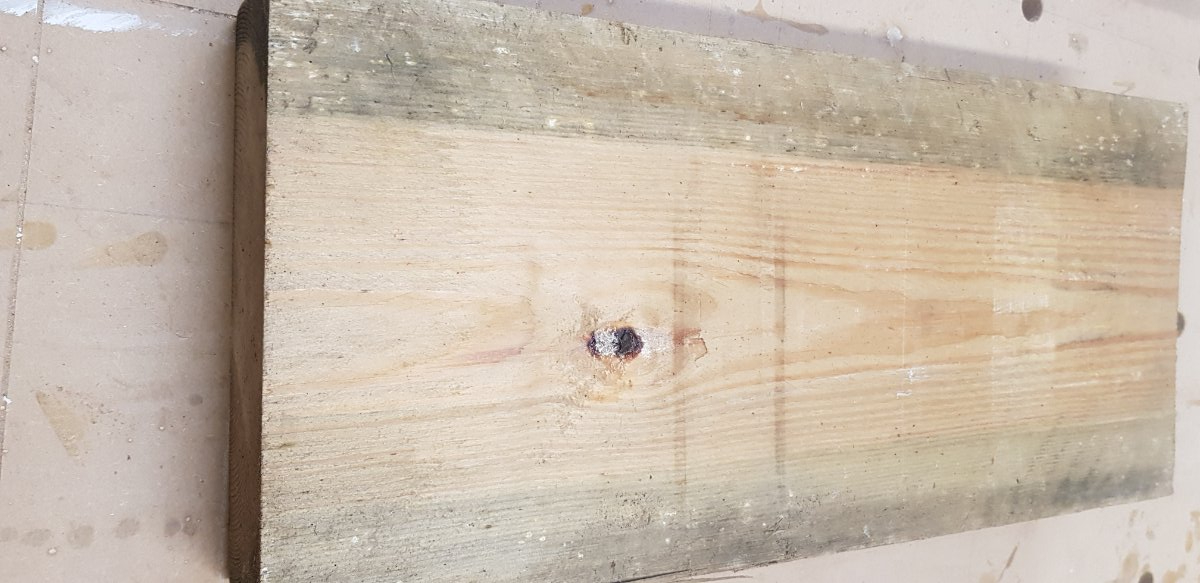

It blew up. 'Don't have it anymore.
And the thing is, you can still get away with just pushing the planks through the site saw until you have an acceptable reference face to work off. I know it's not going to be perfect but often the beauty is in those tiny wobbles and imperfections to the shape.
Sometimes getting it too right - is just wrong!
That's fascinating to know about grades of pine. You can tell from the photo that that is a good quality board.

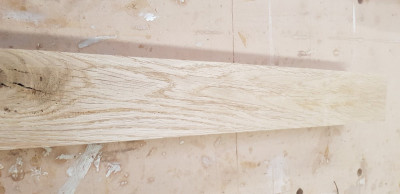

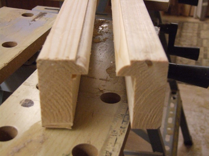

I tried to post this the other day but it wouldn't let me.
Anyway, this is the only moulding I've made from a piece of PSE square wood.
I used my router (freehand) and my cheapo table saw. It was for a 'rustic' finish moulding so
it was forgiving of any irregularities but it came out well and was used on a customer job.
I roughed up the face and back with a wire brush.
Otherwise the most I ever tend to do is apply a round-over + quirk to an existing square moulding or
cove or chamfer. I now have a half-decent router table for this.

Yes, A router table is a good way to go for small one -off jobs. It also gives the operator a taste for the concept of carving out their own profiles.
That's quite brave of you to use PSE timber.
I used to use a lot of the pine stretcher from R&H as a base for many of the frames I made.
Because it was much cheaper than obeche, relatively knot-free and felt heavier and more substantial, I thought this was a clever and well considered move.
However - fresh pine is quite a 'mobile' timber.
On thin profiles you can get away with it but on very wide profiles, 3 or 4 inches, then the wood can shrink significantly across the grain, meaning that the nice tight mitres that left my workshop end up splitting open when in the customers warm living room!

Another thing, I'd love to make my own ripple pieces too. Does anyone here make ripple pieces using regular machinery? I can make basic some fairly basic stuff on my router table but that's about it.
Here's a frame I made based on some R&H A112.
Matt
Matt
