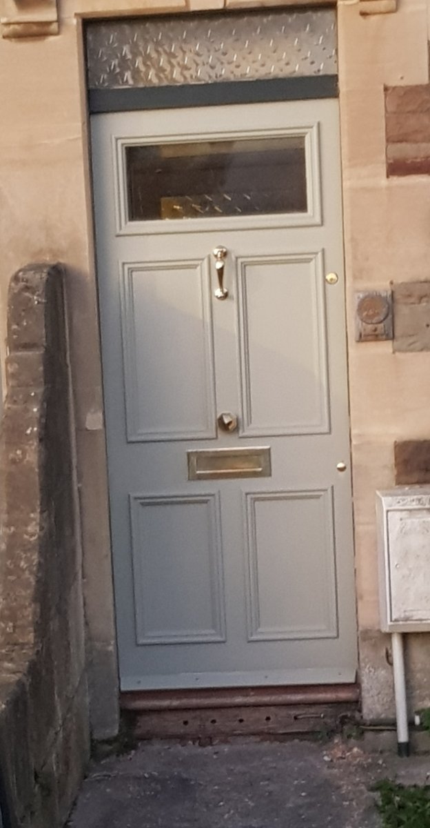

Thought i would share this to show that the morso and underpinner can be useful for other jobs. I machined those mouldings on this door, put in a reverse rebate so they sat over the door rails and stiles. These were cut on the morso and pinned making life much easier.
What it made me think was for people who don't have the machines i have to make a door from scratch, if you buy a plain panelled door, you can make a fancier door adding your own mouldings. It could work with cheaper kitchen cupboard doors.
The mouldings on this door transform it and this house is in central Bath so it is in keeping. If you walk down this road, almost all the doors have mouldings and not one is the same.
This is not framing so apologies if not of interest to most, but it might inspire someone to find ways to use mouldings for different ways maybe doing some diy on their house.

This is great Nick. I think it definitely has a place in the forum.
I used my morso to cut architrave moulding for around a door, but quickly realised that the angles were nowhere near 45 degrees, so I had to keep shaving bits off until I got close.

Brilliant transformation on a door.
I did the same once but around some new windows we had put in ( box sash - of course). I was able to build a wide architrave with several different mouldings all around the inside so that it all looked rather splendid and important.
It works a treat around internal doors too, as pramsay said.
