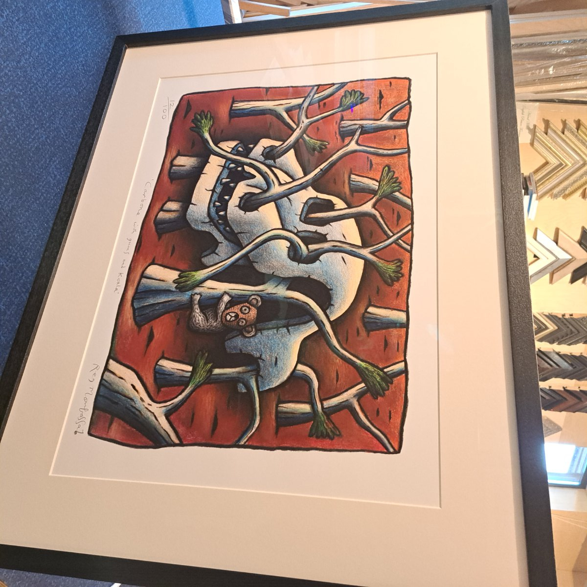

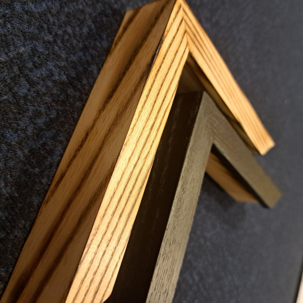

So here is the Reg Mombassa limited print brought in before Christmas, a present for the husband. (Reg Mombassa did all of the Mambo clothing designs in the 80's-90's. The customers were an advertising agency creative team, so like to be very involved in the design process. The wife wanted something that gave a nod to the image and the title "Carbone with gums and koala". So playing on the "carbone"/carbon theme, could we experiment with the japanese burning technique. So, it's a fairly straighforward process with a canister gas gun, it was just about burning enough for the start of the charcoal look. Within reason, I don't think I could have overdone it but it was easy to underdo it, as you can see from the black sample chevron on the right. I experimented with a much lesser burnt ash look too, as on the left (if the photo loads the right way around...unlikely..)
Here are some of the images of the finished piece.

The sample on the right in the top photo was lightly scorched, black but not heavily charred. (not that obvious in the photo). The problem with it was that it looked identical to a painted wood frame once it had a coat of flat matt on top (which was necessary to seal the charring).

Very interesting how did you get the uniform lines on the burnt ash look sample,

Thanks, the uniform lines are the wood grain. It is actually burnt ash! I just used the gas burner like you'd use a speay gun, slow even passes.
