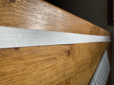

For some reason everywhere seems to have stopped stocking the hinging tape I always used.
I ordered a couple of different rolls and they both are like this. To me this seems like faulty tape? Yes?
What's your preferred hinging tape?
