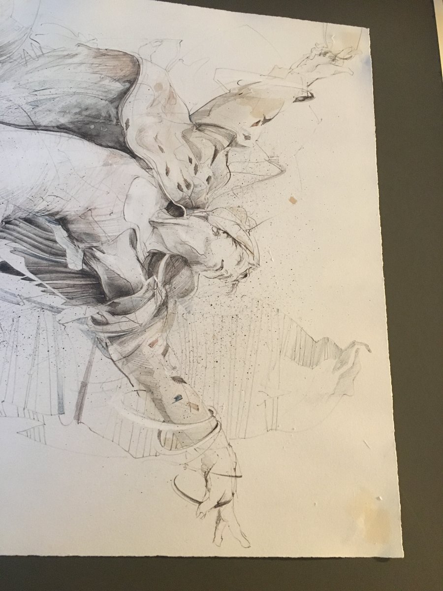

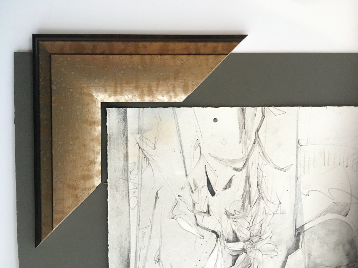

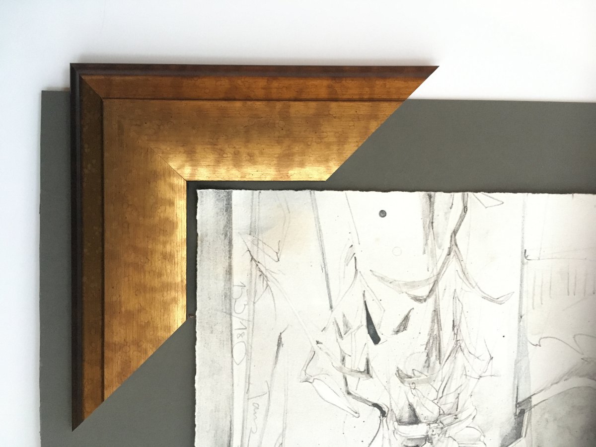

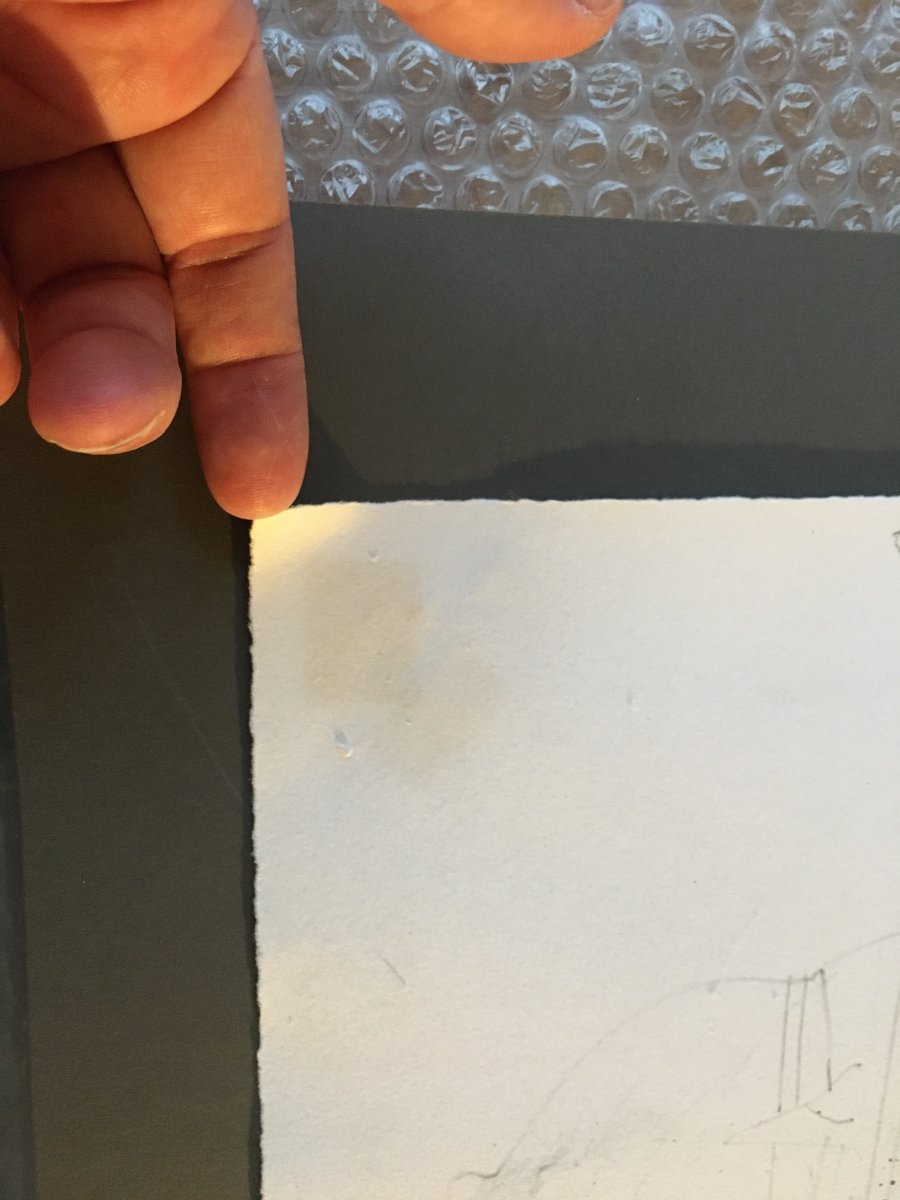

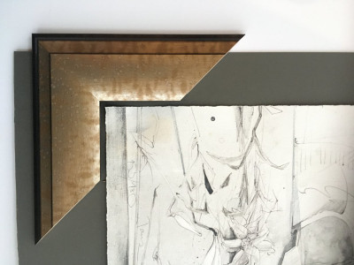

Hello again,
A customer has brought me this to be re-framed. It is very well loved, but has been previously stuck down with double-sided tape onto basic board which is now showing through. I have had a very tentative feel and am not willing to try to remove it as I think it will tear. I have told them my magic wand is broken.
But I'm not really sure how to approach re-framing it style-wise. They are looking at chunky dark frames (LJ Urbane 432436000), which they love in itself but does not really go with the colour board it is on (sort of a browny-grey).
I could cut round the board and the lip of the frame would cover it, but that would lose the deckle edge they like. They asked for a sample of this gold frame, but I'm just not sure.
I'm not feeling it myself and struggling to know what to suggest really. Is there a trick I am missing? They are stuck with the current board aren't they?

They're not necessarily stuck with that board.
A paper conservator could remove it and any residue, it's worth finding one, or two if you can, anyway. (Regards your other current thread - then you'll find someone who DOES know how to charge
You could also put a new mount as close as possible to the edge of the paper, revealing just a sliver of the old one, it would look like a double mount.
Some framers would have a go at removing it too - it may come off easily with heat and any residue maybe can be removed with a mixture of pumice and French chalk. I'm not suggesting you try that but a rummage through some antique shops' "ephemara" boxes will give you plenty to practice on.
If they like the look of that chunky frame that's fine but I think wide mount and narrow frame (in relation) always looks best for most stuff like this.

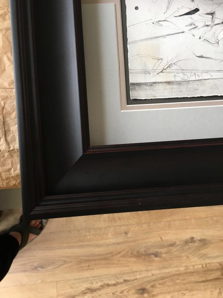

Thank you all.
I hadn't even thought of adding a mount and we have ended up with a double mount.
Well the customer came and we had a good old time playing. They randomly picked up some mount colours which we hadn't thought of, but they actually work really well and tone in with the picture, frame and board. So we are going with this. Sizes to be tweaked and the photo washes it out, but I think it is going to look really nice, and the customer was almost jumping with excitement.
AND I priced it up properly this time using FrameR

That looks great!
