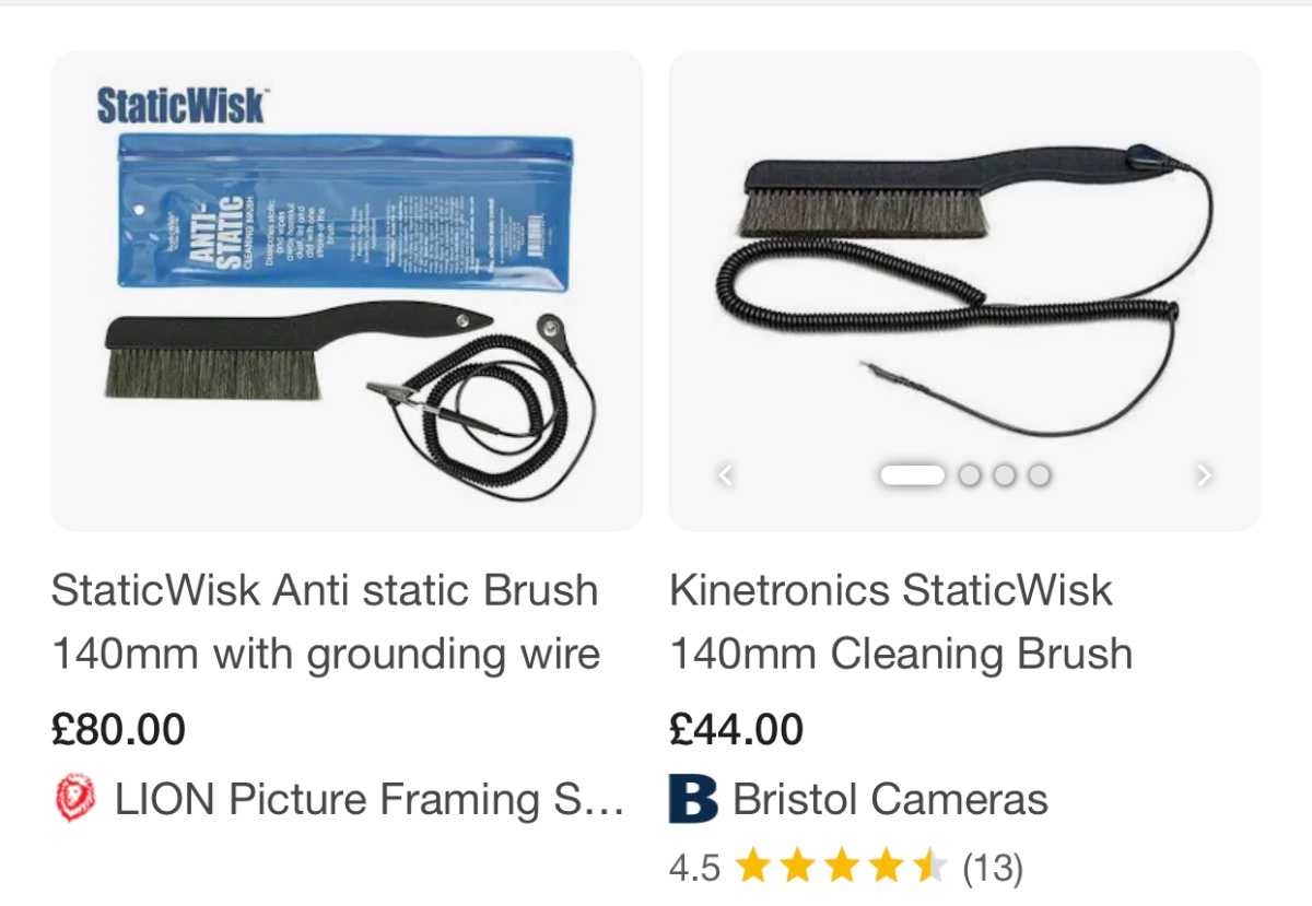

There's notrhing wrong with paper towels/kitchen roll etc for cleaning glass, it's what I used. Cloths can become quickly contaminated with oils from your skin (I had a particularly slimy framer once, big problem) whilst paper towels are always fresh. Good quality (not pound shop) microfibre cloths and even miocrofibre towels can be good sometimes, especially on fragile coatings and/or for fimal polishing, but they need washing daily. Maybe not so good on artwork though.
I had a couple of these for dust and flumb removal from fragile surfaces.

Do the anti-static brushes work?
Like this one:
https://www.lionpic.co.uk/p/8964/Static ... rush-140mm
Posts: 620
Organisation: Retired
Re: Wiping dust from photographs
Post by JKX »
Yes they do, the version with the earth lead is best though.
Shop around!
