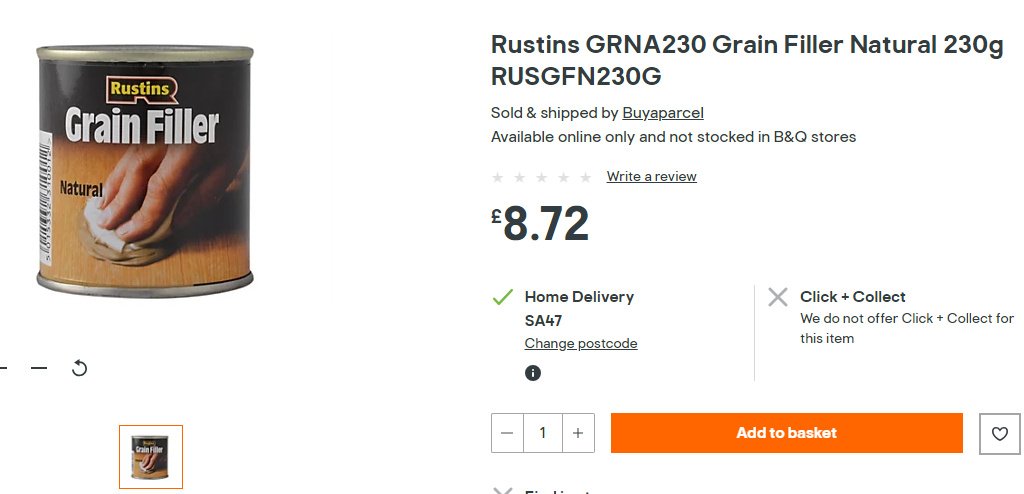

Yes, obeche grain is pretty horrible.
One solution is to rub in some Rustins Grain Filler.
Rub lots on with a cloth then take as much off again with a cloth.
Do it twice when the first coat has dried.
It's important to remove as much as possible, across the grain. Otherwise, you can get lumpy bits showing through when you apply your final coat of finish.
When that has dried, sand the surface with 320 grit paper and wipe clean.
