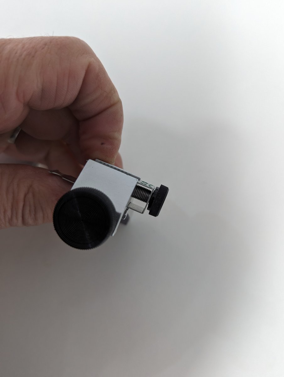

I have/had this issue, are you using Tech S 12 blades? Does the spring in the adjuster become coil bound, what thickness board are you cutting?

Tried both tech 12 and 15. Think thickness is 1.2mm, sorry not sure what you mean by coil bound? Can you elaborate

You run out of fine adjustment because the spring is totally compressed

Yes I'm on total adjustment, spring totally compressed and still get a large overcut on start of cut

Are you definitely using the single end S blades? It is essential that the blade only just cuts through the mount into the slip, backing off the blade reduces the sweep and the overcut and reduces hooking

The adjustable stop is dialled to the amount of error and then reset to to what's required - eg you want 75mm but the cut starts 73mm away from the edge of the board. Dial the cursor 2mm (forward I think) then reset the stop (move it back) to the 75mm you want. All you're doing is moving the cursor dial to what it's actually cutting to (73mm) and then moving the whole stop back so the cursor reads what it should be
If you've somehow run out of adjustment, which is odd, then check the scale is fully home in its housing and if it is, then the only thing I can think of is to adjust as per the older machines - move the scale to the stop instead of vice-versa. The old scale could slide in its channel, all being well this is still the case, or it can be adjusted in its housing, otherwise you'd have to unstick it and re-stick it. If you have to resort to this, dial the stop to half way first so you can adjust as per the manual ... in the futura
