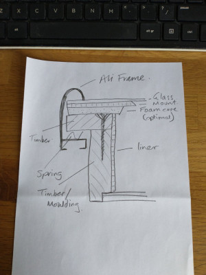

Re: Aluminium box frame
It depends how deep you want to go. This is a method I used for deep box frames with an Ali frame. It also means you can put very thin frames on large pictures because the timber frame and box is the main strength of the construction, the actual frame is a bit of decoration on the front.
