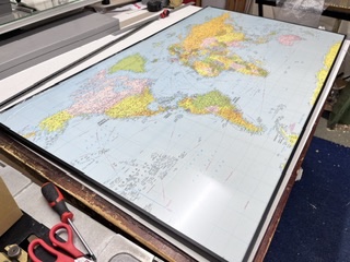

Re: First time using aluminium frame
A few firsts for me on this one, and a practice run drymounting after finding the same map on eBay. But it has finally been manhandled into submission. Thanks for all your help. I think I will put a framestrap on to be on the safe side. I don’t want it back!
